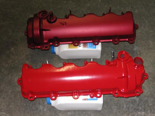

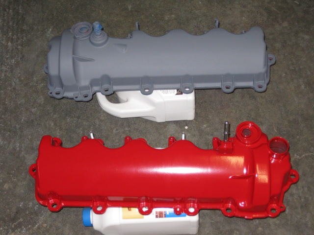

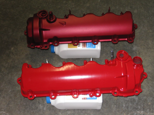

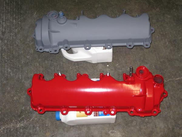

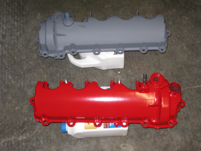

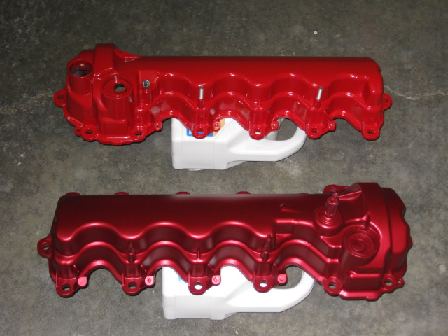

Valve Covers
Here's a set I'm doing now. Started with a set of new, red powder coated covers I got from a forum member here. Had a paint shop make up a few cans of paint to match my Redfire color. Scuffed them up, 3 coats of high temp primer, 3 coats of paint, and 3 coats of high temp clear coat.

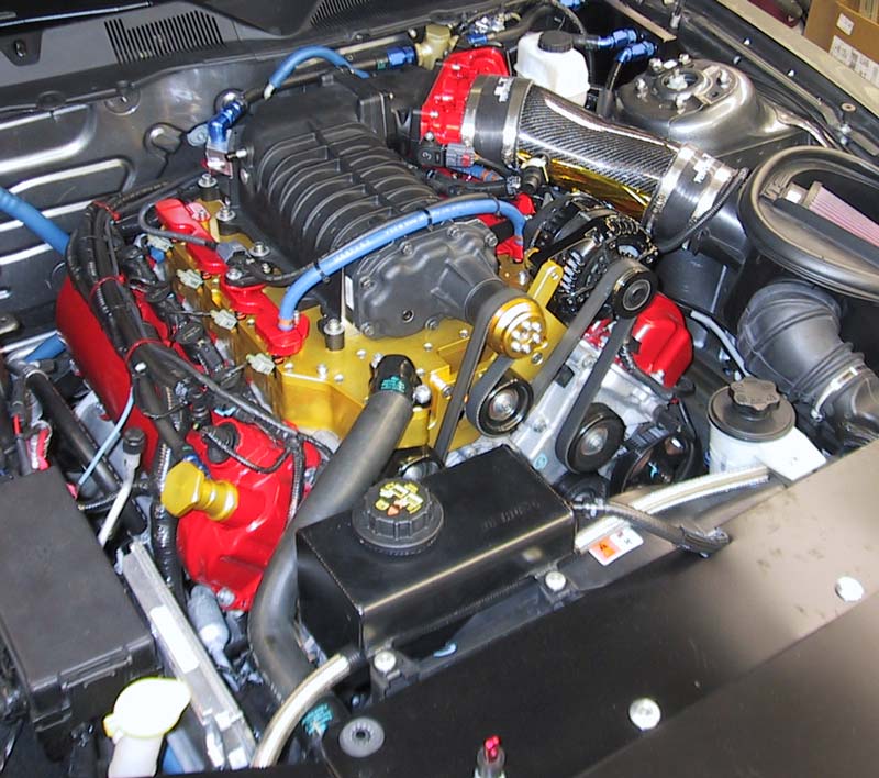

I was looking for a more subtle effect.
