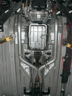

Alrighty well I was in the garage today and I was jacking the car up when I realized I may have done some damage. I had the jack in the wrong place and seemed to have crushed some type of plastic covering or somehting. In the picture, the piece I have crushed is circled in red. If anyone can shed some light on what I may have done that would be great!

I dont think that plastic does anything. I yhink there is something underneth the rockers that can be lifted by

Looks like a cover to protect the fuel and brake lines. You might want to pull it off to make sure nothing got pinched. The cover itself should be fine.
Exactly

your fuel filter is under that too
the cover is held by a couple bolts and one or two push pins (i $#*^ing hate those!)
