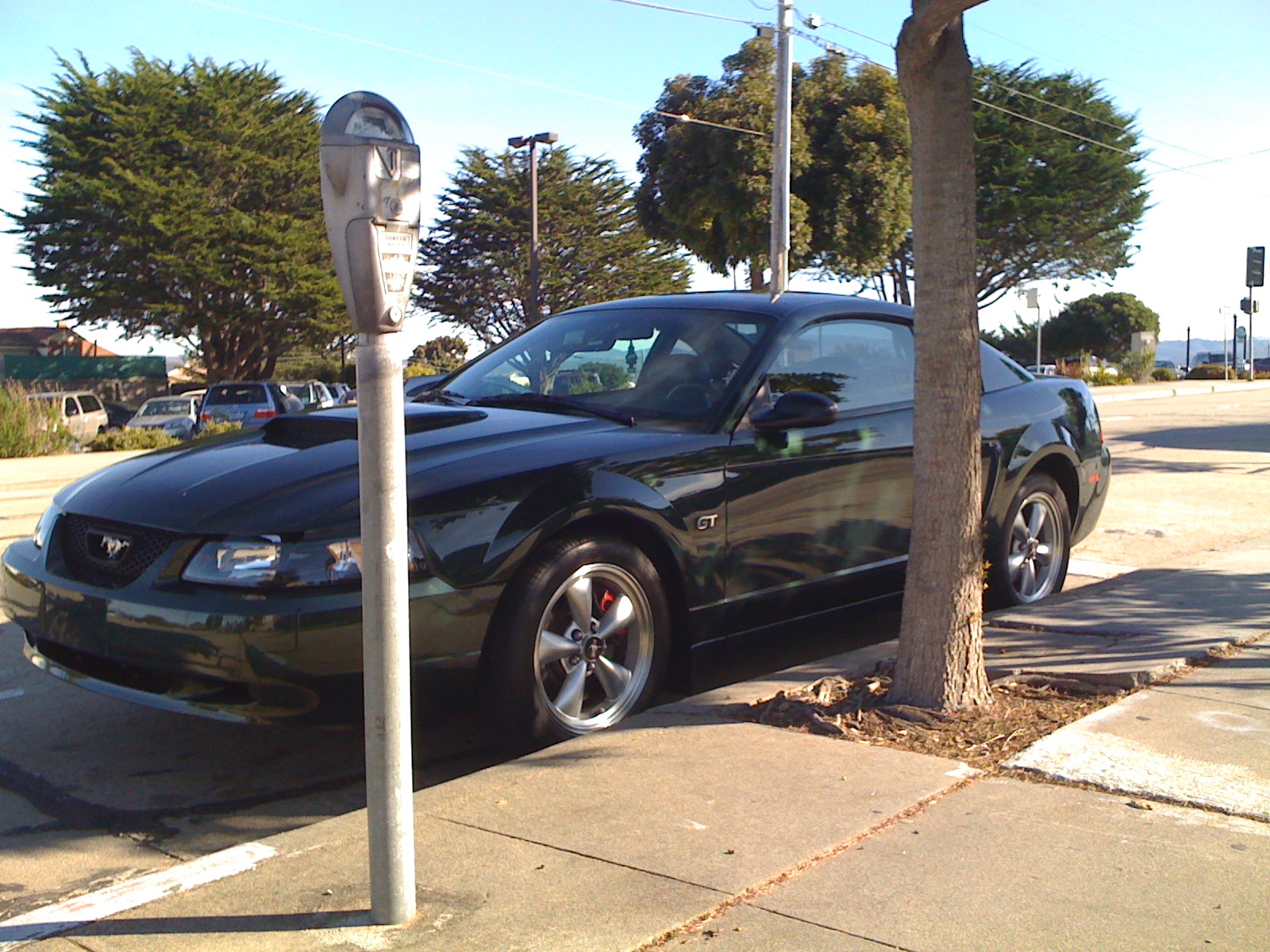

Hey guys . . .. . look at this picture of my Mustang from yesterday in Monterey, California . . .. . . doesn't he look happy . . .. . .with a set of Pirelli PZero racing tires?
Merry Christmas to all!

nice how are they in the snow
