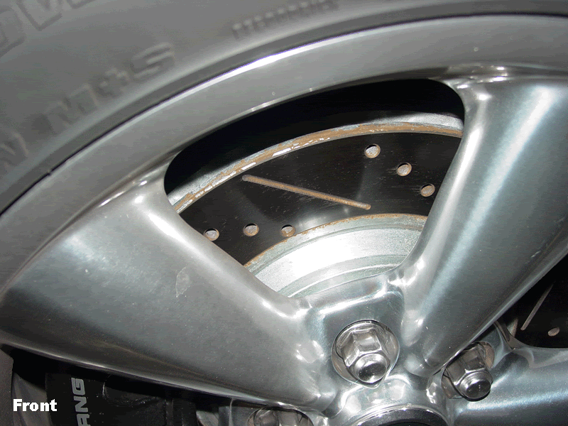

Anyone who has zinc plated Rotor Pro rotors, are they rusting?
Mine are and I only put them on a little over three months ago and have only cleaned them with water, no chemicals per Rich's instructions but it looks like the Zinc plating it flaking off now. It's rained maybe four times down here in that time with a pretty heavy ran yesterday.
Here are a couple pics.

That looks like pretty normal rust run off when rotors get wet. You should see the rust streaks I get on my rims after not driving the Stang for a few days then driving out in our Seattle rain.
As for the zinc flaking off... doesn't surprise me since brake rotors can get up to 900+deg real quick. Maybe that rotor wasn't washed properly when they zinc plated it.

True but if I am not mistaken the plating is supposed to last longer then 3 months. Not talking bad about Rotor Pro's either, just looking for info on them. I am going to contact Rich from there to be sure. Just curious is anyone else has them rusting like this so soon.

The brake guys here tell me that the zinc plating should help to resist rust for years, not just a couple of months. MAYBE they just had a bad batch?

Rich got back to me. It looks like the only thing I can do is what Tom (89Trooper) did and paint them. Rich said to use VHT paint so it looks like I have a project down the road. The hubs are still good, it's just the edges. The only thing they can warranty is cracks and warping. All good, I'll see what I can do with the paint.

GPS,This is normal for the rotorpros. Buy VHT high temp clear coat . Clean the rust off thoroughly.Then spray the whole entire rotor ,let dry thoroughly,then put them on. The brake pads will take off what you don't need and the rest will remain protected w/ clearcoat. There is a thread about it on TMS. Do a search

Make sure when you run the rotors for the first time after the paint drive and brake hard and often. You want to make sure you clear all the extra paint. Trust me bad things will happen if you dont. I know first hand...
