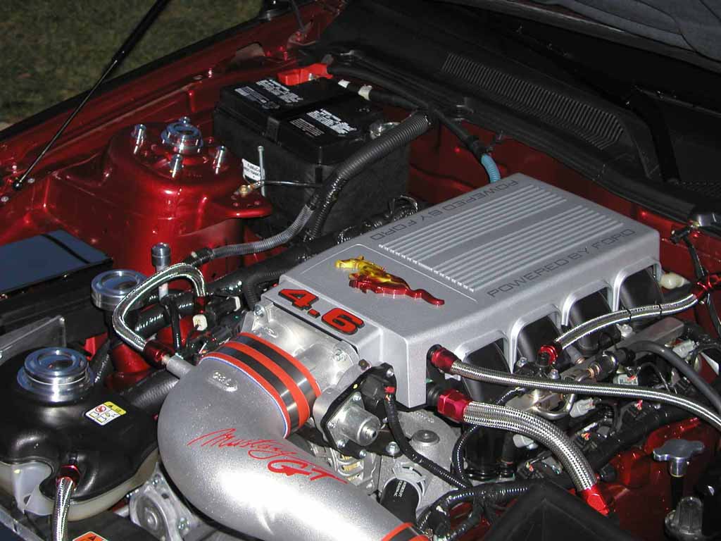

Here is mine, Spectre Performance ordered from Pepboys.com. Searched for part numbers at powerflowracing.com. Ordered seperate clamps and hoses then cut to length. Someone on TMS helped me with sizes but, I can't remember his name.

Looks really good.
Sure that wasn't cheap.

NO not really, cost about 95 bucks for a set up, not doing the radiator hoses. but looks good
