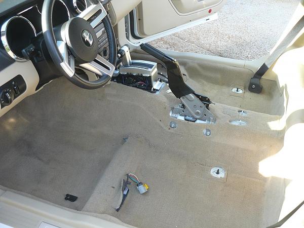

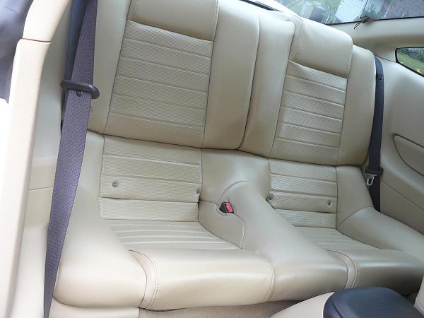

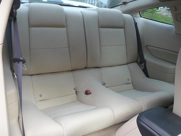

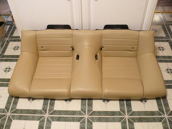

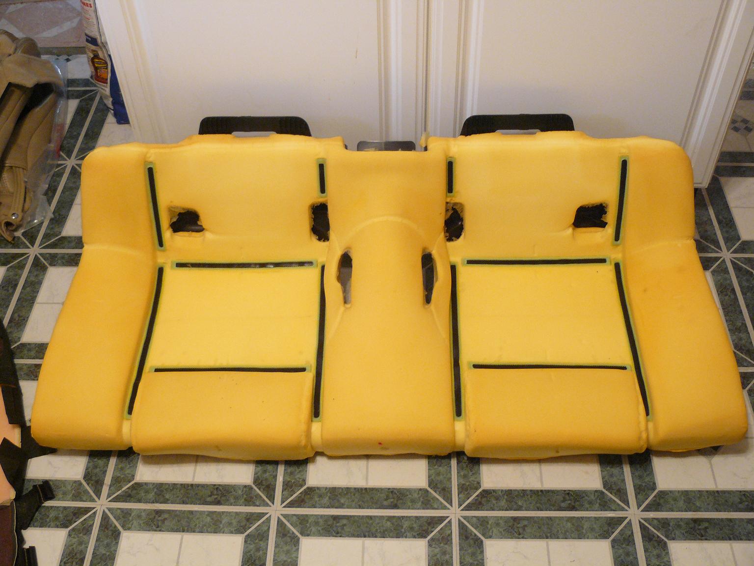

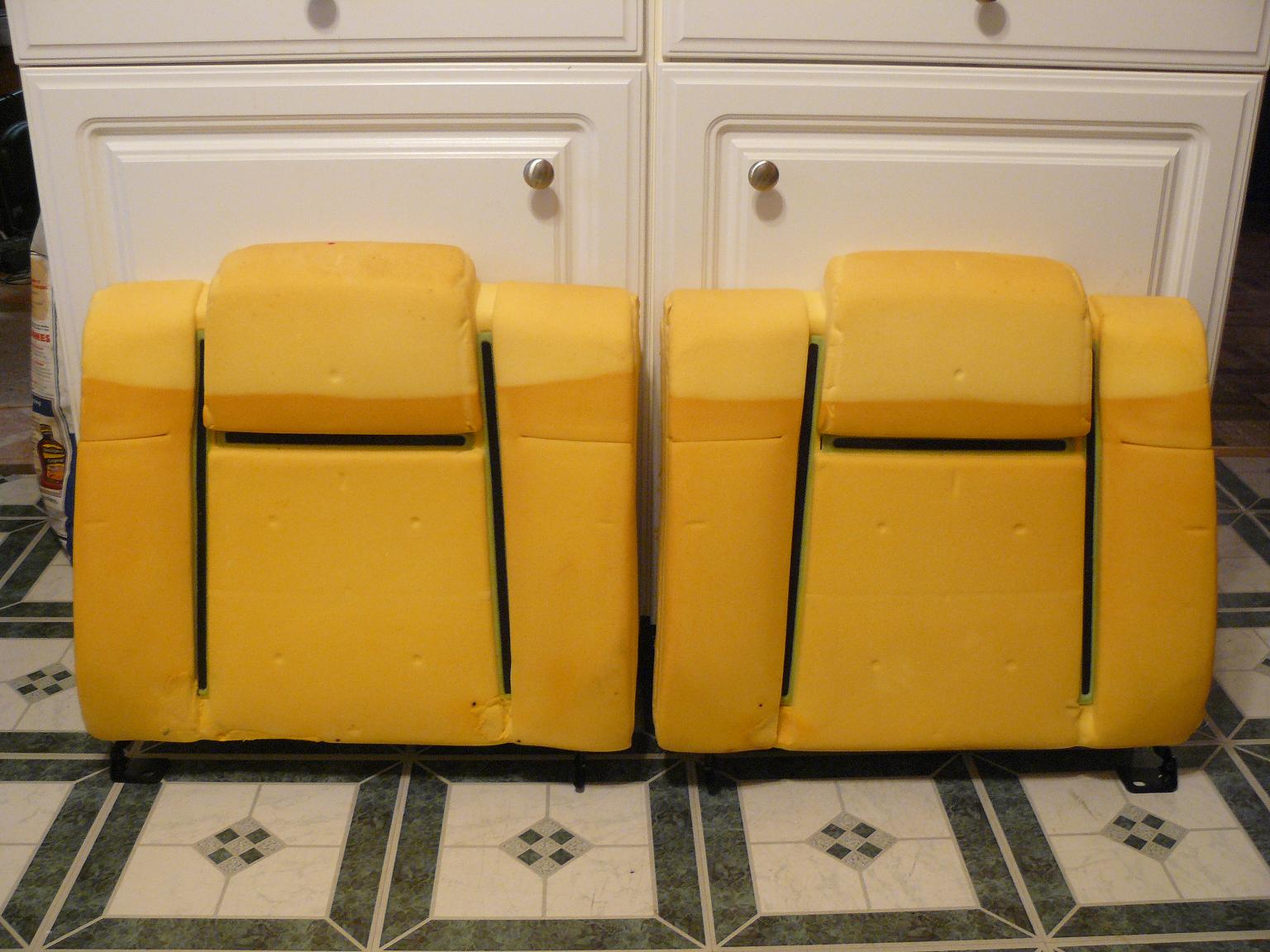

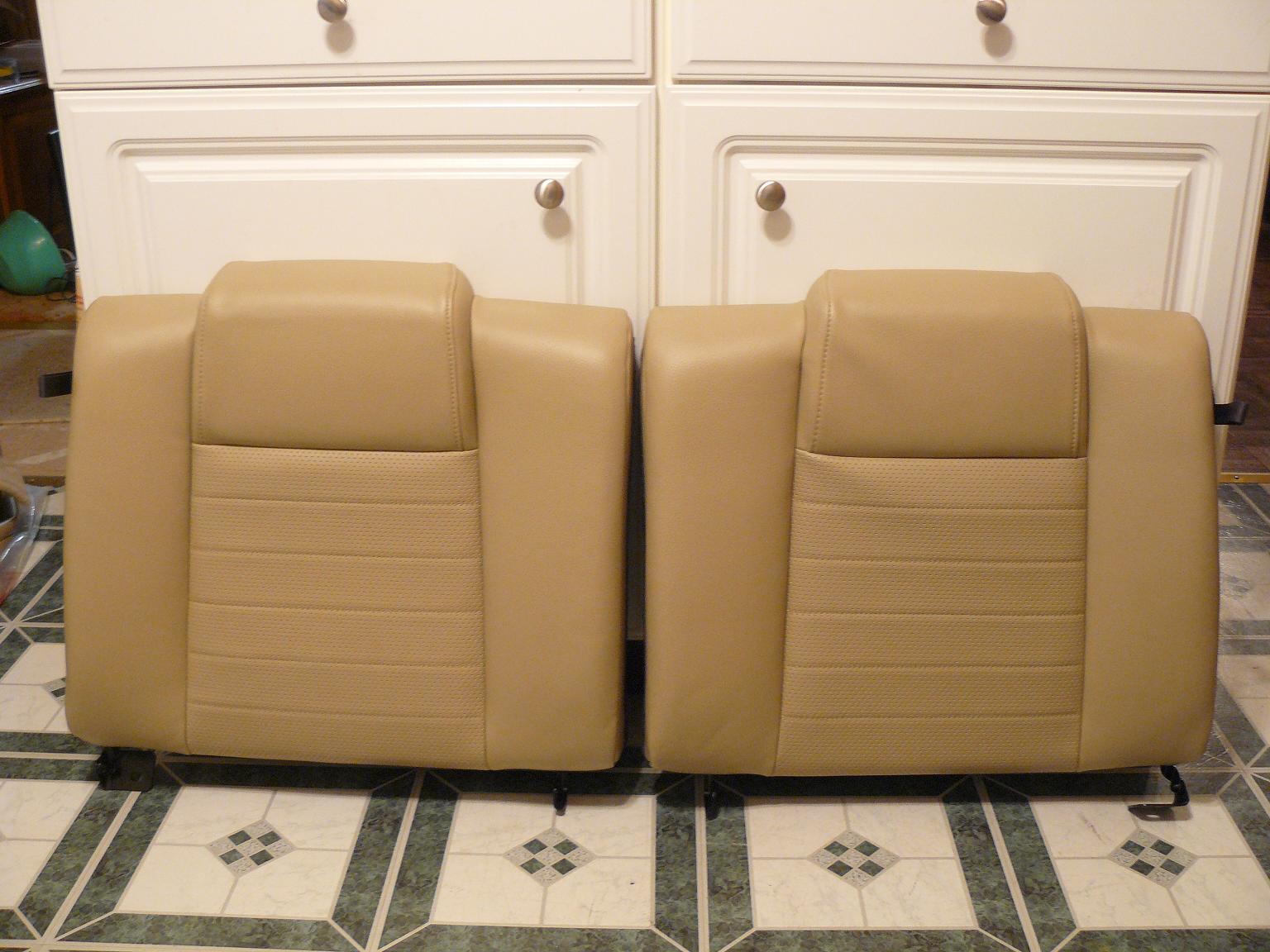

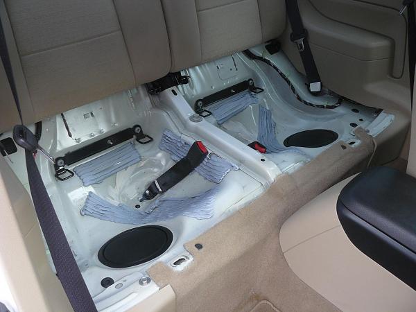

I recently replaced the cloth seat covers in my 2005 V6 Mustang and swapped them out for the OEM leather seat covers. I had been wanting to do this for some time now and had been looking at possibly getting a set of katzkin leather seat covers since I had not found OEM leather seat covers in tan. As luck would have it Hatchman had posted a set of good used OEM tan leather seat covers out of his 2005 GT Mustang in the for sale section of the forum. I purchased them and installed them myself a few days after I got them. The installation process was quite simple and self explanatory. The only major pain was the hog rings in both front seats but once removed zip ties worked like a charm to attach the front seat covers to the seat foam. I am very impressed with how well the results of the project turned out and how easy it was to change out the seat covers. I have some before and after shots posted below. Oh and kudos to hatchman for the replacement covers!
