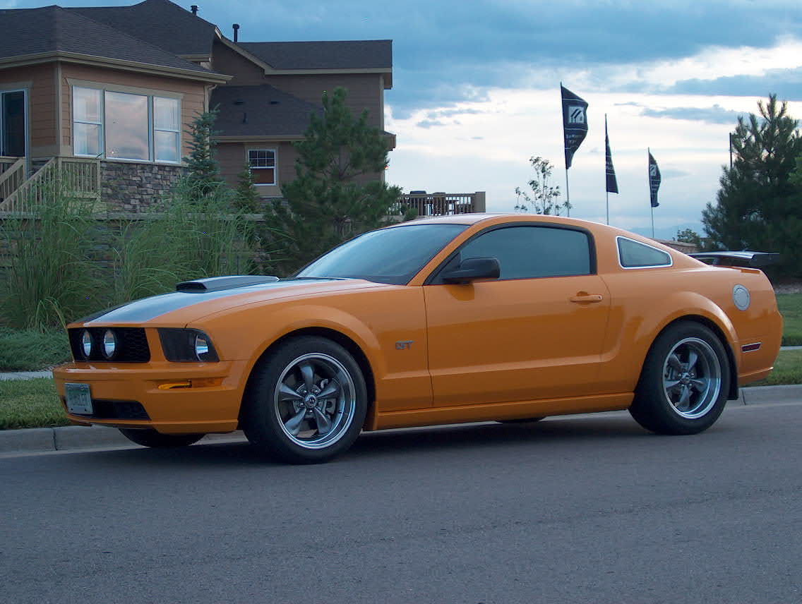

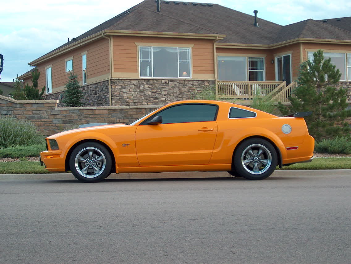

Don't run a 1' spacer on a dd Bullit wheel.The 18x9"DD Bullits have a 34MM offset and barely clear the fender wells with a 255/45/18 size tire.If you stagger the wheels run a 18x10 DD Bullits on the rear.They have a 45MM offset and the backspacing is deep enough so the wheel doesn't stick out.If the wheel sticks out the tire will rub and cause damage to your fender well.I now run a 295/45/18 18x10s(rr)255/4518 18x9(frt) for a staggered set up and they fit great.
Attached Thumbnails OK, so this is a sorta strange request...-hpim0274.jpg   OK, so this is a sorta strange request...-hpim0273.jpg

Poco, that picture there in your post (looks awesome by the way ....does that show that set up you now run (295/45/18 18x10s(rr)255/4518 18x9(frt)?

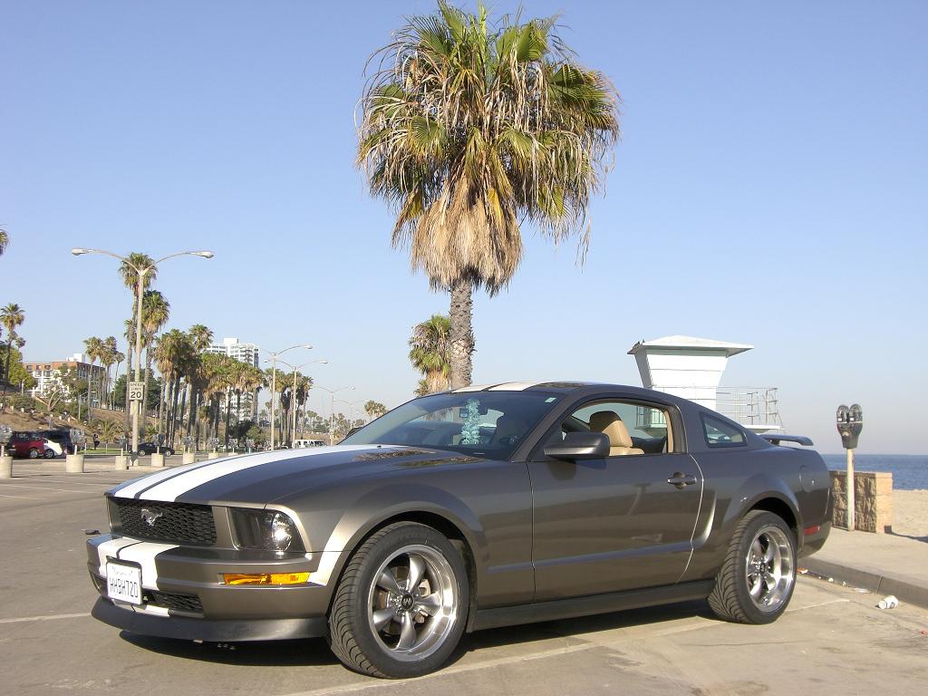

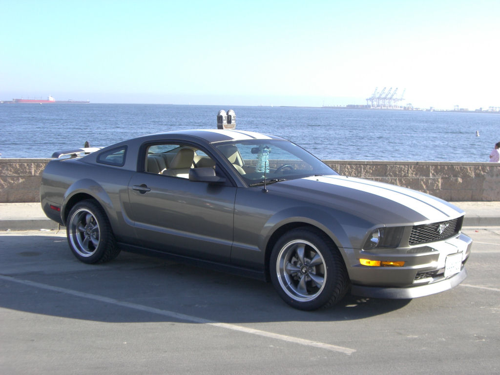

I run 255/45-18 on 18 x 9's in front and 275/40-18 on 18x10's in the back...
I've seen 275's on 18's all around, though...
Here's mine:
Attached Thumbnails OK, so this is a sorta strange request...-wheels3.jpg   OK, so this is a sorta strange request...-wheels8.jpg
Thanks and yes,those are the tire and wheel sizes I now run.I took the 18x9'sw/255/45/18's off the rear.Way to dinky for me.
