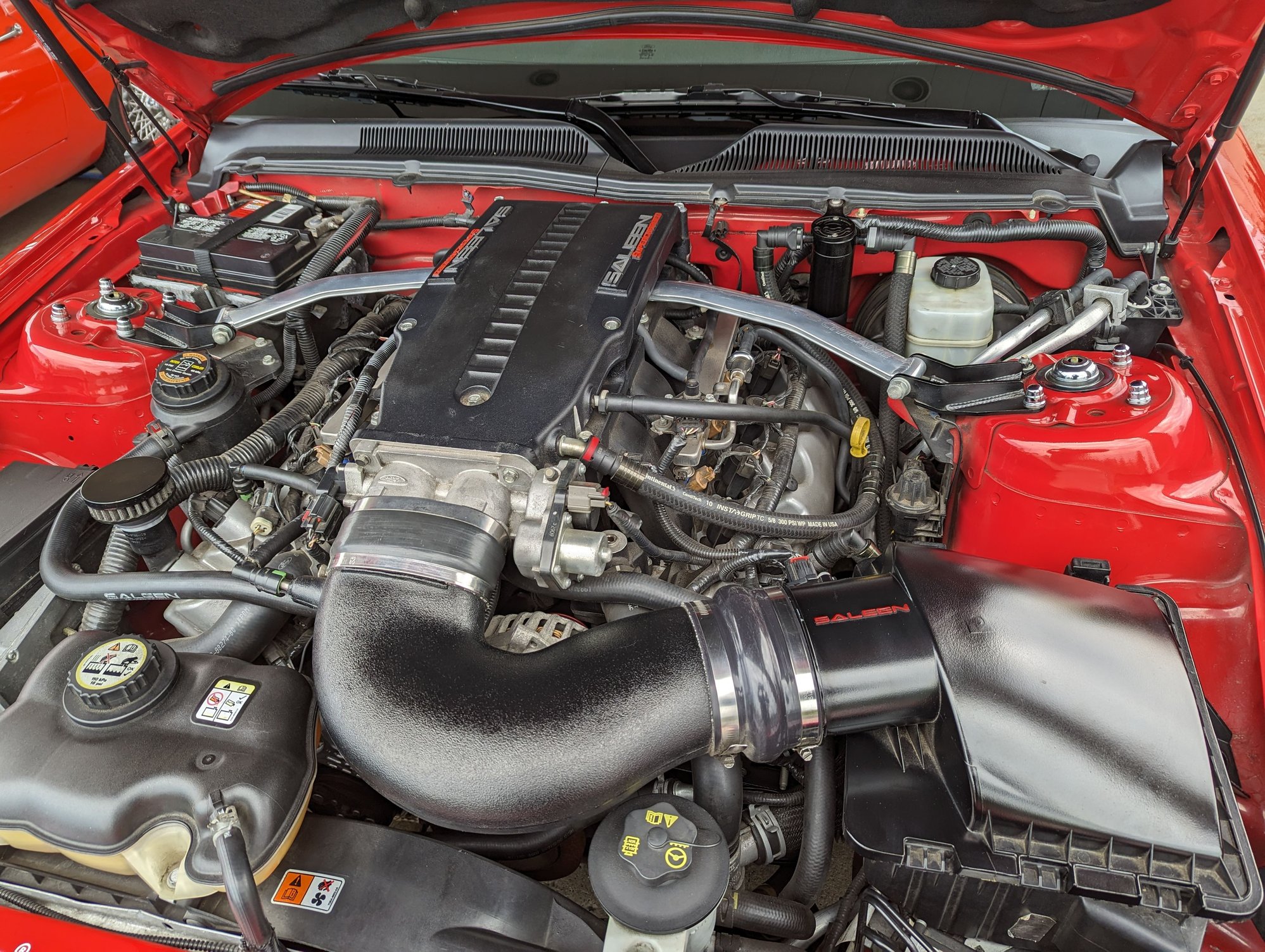

Just to clarify, the PCV on all 2005-10 S197 3v models is on the driver's side... The passenger side is the clean air side... When the 2011-14 Coyote 4v cars arrived, Ford changed the PCV design over to the passenger side which has a removable PCV valve...
The PCV on the older 4.6L 3v models require uninstalling the driver's side cam cover and then cutting out the PCV meter from the underside of the cam cover... I've seen some S197 3v cars with catch cans on both sides, but mostly on the driver's side...
My 2006 GT w/catch can on the PCV drivers side location...
My 2006 GT w/catch can on the PCV driver's side location...
