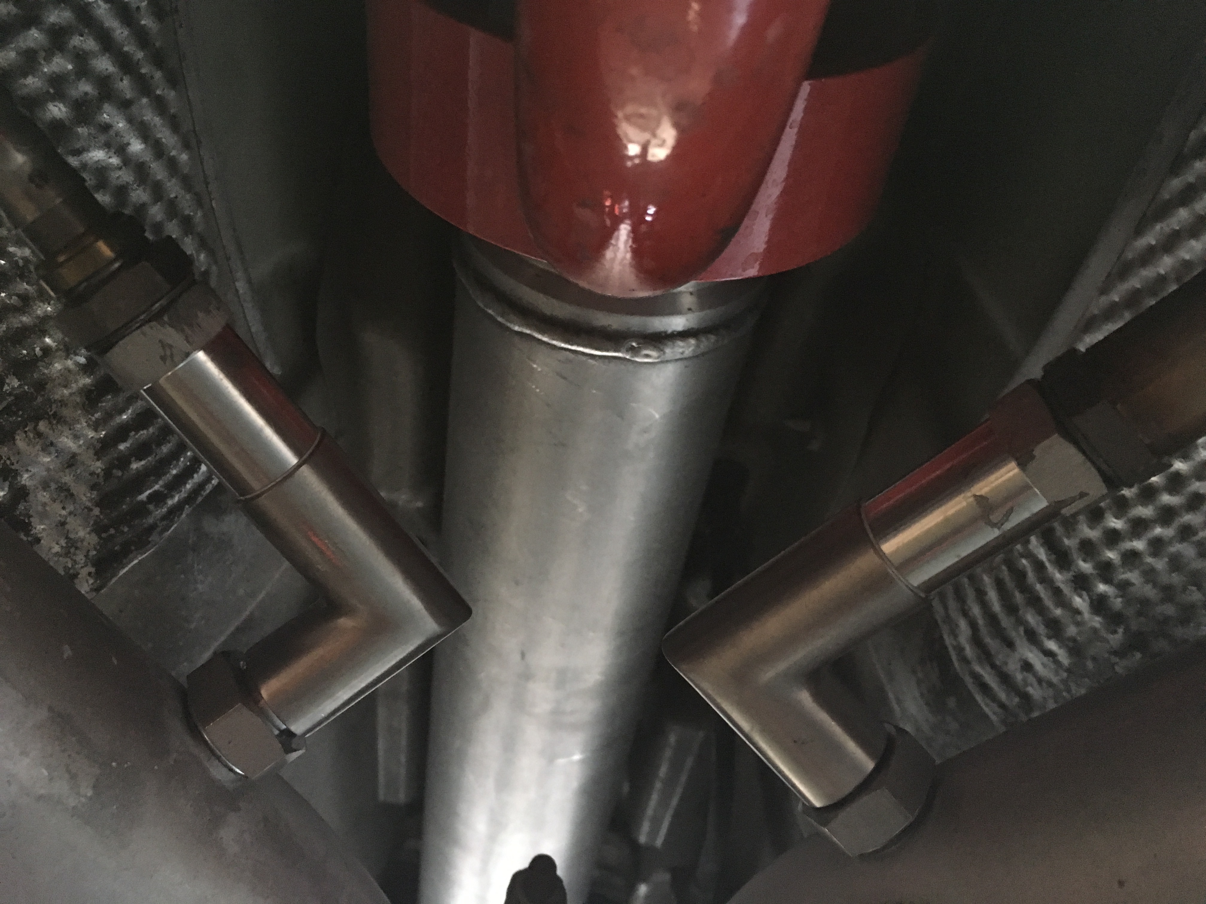

I got a set of these mini cats, along with the angled piece (needed to fit with my exhaust).
http://www.bigdaddiesgarage.com/mini-cat-cel-fix.html
They work well passing this year. I tossed my old catted mid pipe that I swapped in every year for testing.
