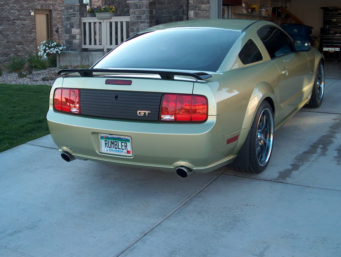

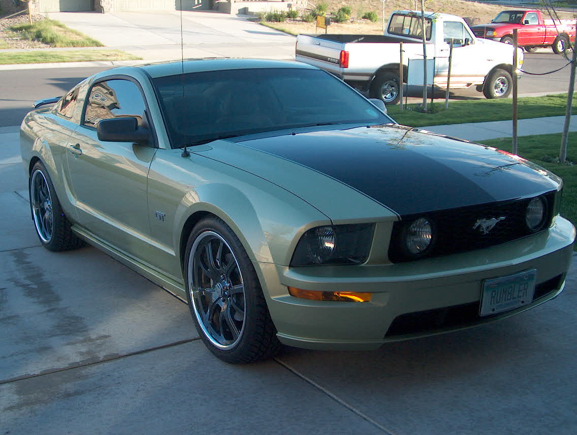

I ran 20X8.5's with no steering stiops on my 06'GT and it ran fine with no speedo adjustment...go for it! Run em,roll em and don't forget to breath
Attached Thumbnails Installing 18" Fanblades on 2005 GT w/17" wheels-hpim0199a.jpg   Installing 18" Fanblades on 2005 GT w/17" wheels-hpim0198a.jpg
