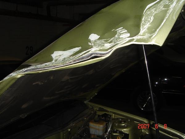

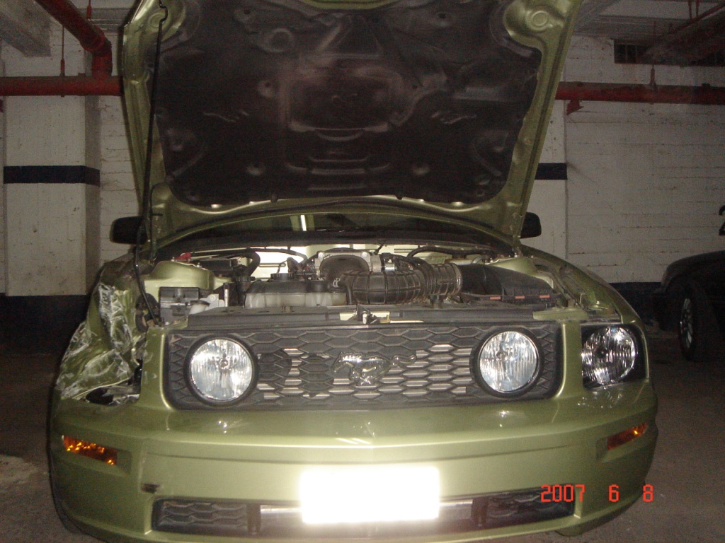

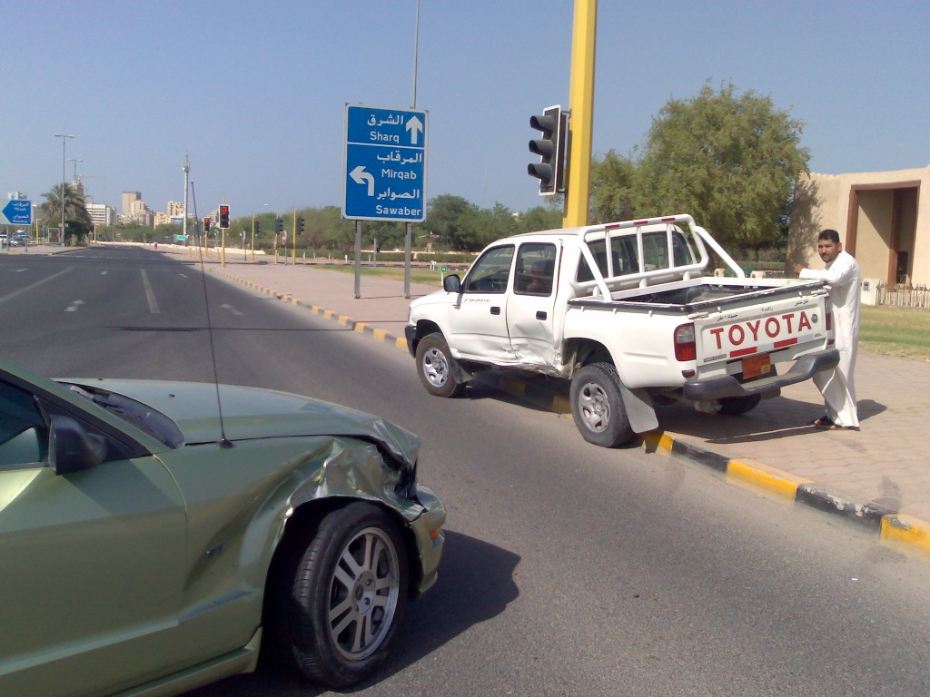

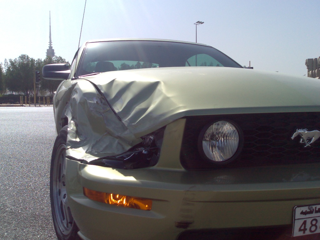

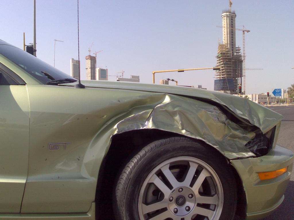

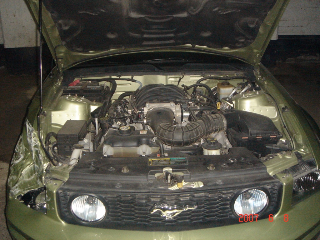

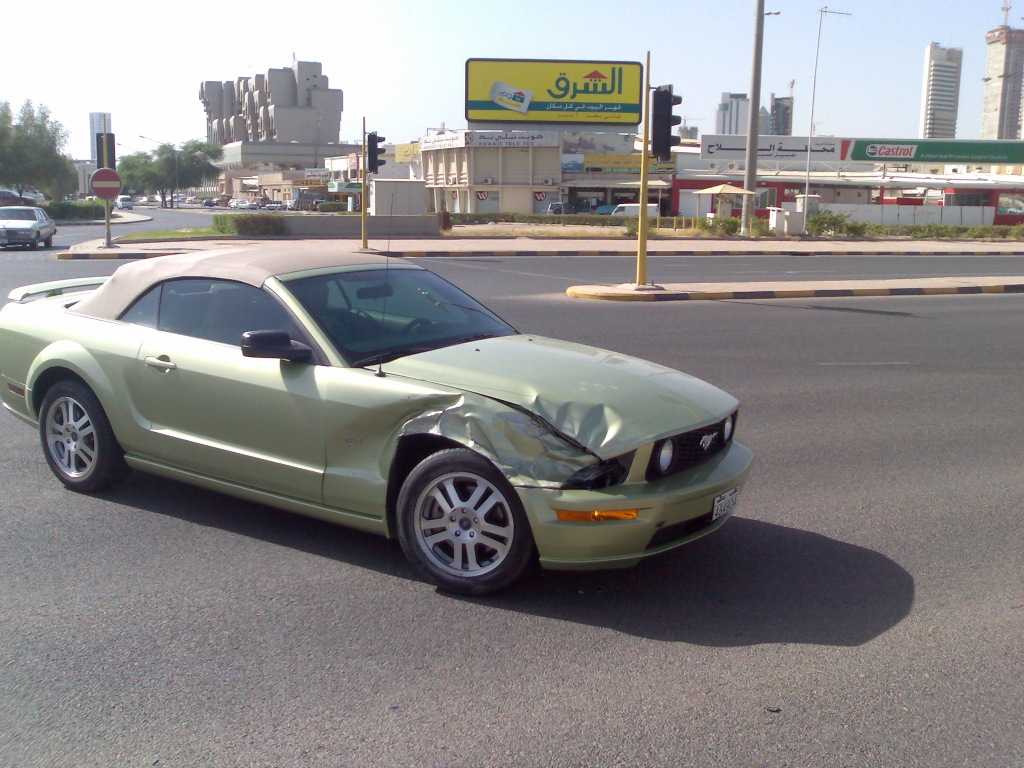

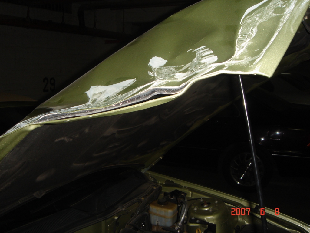

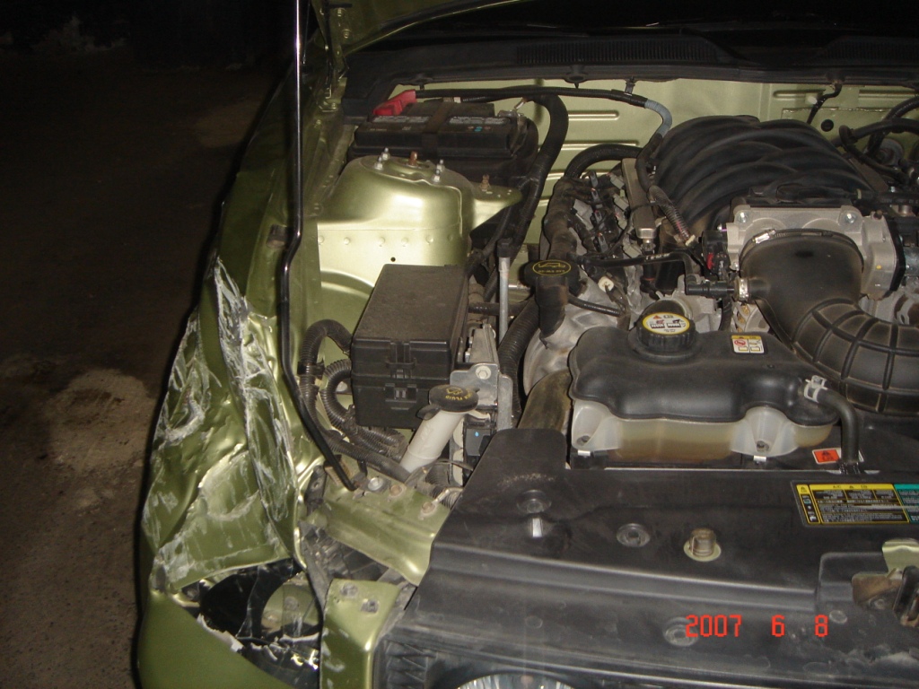

Well the title says it all. I was leaving work today going through an intersection next to my office when an idiot in a Taliban style Toyota pickup ran the red and smashed into me. He even had the audacity to try to deny he ran the light, but thankfully this was right outside the Ministry of Interior and the place was littered with cameras. The cop told the guy to come clean, or else if he checks the video and he’s lying he will charge him with perjury. He came clean and admitted, and the cop still charged him with perjury because he lied initially. After dealing with the cops I noticed that my thumb was three times its size. Well turns out its dislocated and that was a whole world of pain popping it back in. I took some pictures of the accident and close-ups. I don’t think there was any damage to the drive train. Of course I’m not very knowledgeable about this and would hope you guys point me out in some directions. I will try to take some pictures from below tomorrow. Everything is closed on Friday. Saturday I will take her to the dealership. Let me know if I should look out for something in specific.

Ouch sorry for the accident, but can we say shelby conversion ? or a CS front end. with the damage done this may be the time to do it. replacing the hood and bumper you are almost there. If not a conversion an aftermarket hood costs just a bit more than the factory one. take this bunch of lemons,,, or limes...LOL.. and make something better of it.

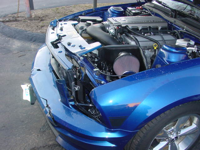

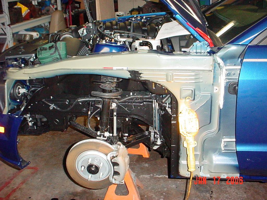

sad to say but you got more than hood/bumper/fender...the upper front of the unibody and the coresupport are going to need some 'work' to say the least...Ive got a pic here somewhere of my car with the fenders off(undercoated the hard way when it was a couple weeks old)
attaching a couple pics- first shows the upper unibody(welded together) structure, second shows the passenger front tip of that- top left corner you can just see the black electrical box...the upper 'arm' will need pulled back into shape, or replaced, be sure they seamseal/paint all the welds- they probably have never seen rust over there, but when it comes back to a non-desert home, you'll want that all protected real well
sorry to hear about another bent mustang, but atleast youre still here to worry about it- coulda been worse...
Attached Thumbnails Idiot ran a red a wrecked my baby !!-nofender-640x480.jpg   Idiot ran a red a wrecked my baby !!-sealing-025.jpg

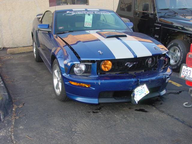

Attached Thumbnails Idiot ran a red a wrecked my baby !!-mom-dad-005.jpg   Idiot ran a red a wrecked my baby !!-mom-dad-004.jpg
What do you mean by 'work'? Are they bent back into shape or replaced? Same question applies to hood and fender.
unibody=either...
fender/hood/bumper will be new
just added a couple pics to the earlier post

Replaced, you will need a new hood, fender, bumper, headlight, Upper rad. susport brace, also looks like inner fender. Hard to tell what other internal damage is done untill it is toren down.
As for some of the aftermarket stuff or up grades, the dealer should be able to get the shelby or CS front end for you. the 08' have HID's they may be able to get those for you too. As for a hood, do some local research.
