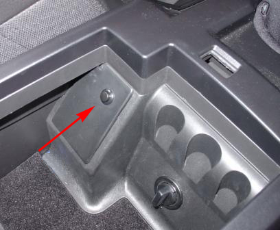

Did the same thing but installed it inside the center armrest. There was room behind the plastic removable cover (the one to adjust the parking brake) to velcro my remote.

I also have a vert, that's why I went with the "inside center console" version. Behind that plate there's plenty of room to put the largest remote without removing the casing.
I only added a velcro and the wire inside the box, and I dodn't connected to the car 12v, I left the battery ans 2 years later everything is still OK.
The batteries in these remote are good for a couples of years, so don't spend time and energy connecting it to your car..
