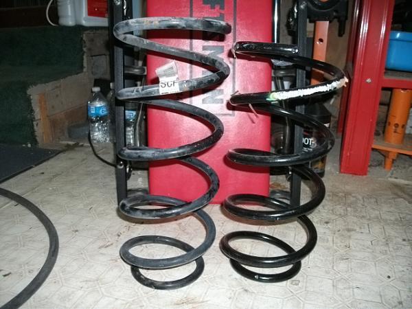

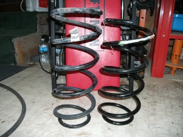

ive been kicking this around on my 05. the bottoms of the frt struts i think could be cut because the bottom looks linear even though its listed as a constant spring.
the rears though i dont think you can get away with it. the springs are not straight, kinda hour glass shaped and the ends are smaller. they look more progressive.
i just put a set of bullitt springs on my V6 frt, they sat shorter on the floor, but raised my car 1/2". i like the stiff ride but really wanted it 1/2" shorter than stock
