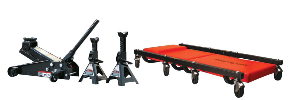

If you have only one floor jack, go buy another, or 3 more.
I have this. Which is $99.
![](http://s7.sears.com/is/image/Sears/00950188000)
http://www.sears.com/sr/javasr/produ...cemldffidfmg.0
And these. $19
All are 3 ton, so don't worry about the weight.
And these. $19
