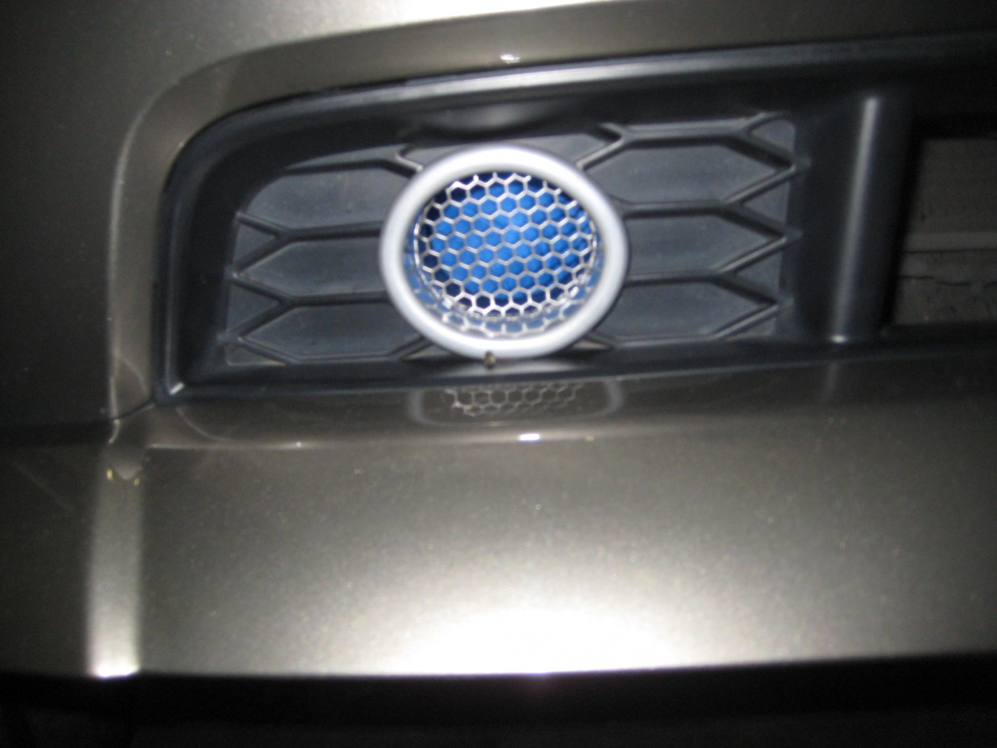

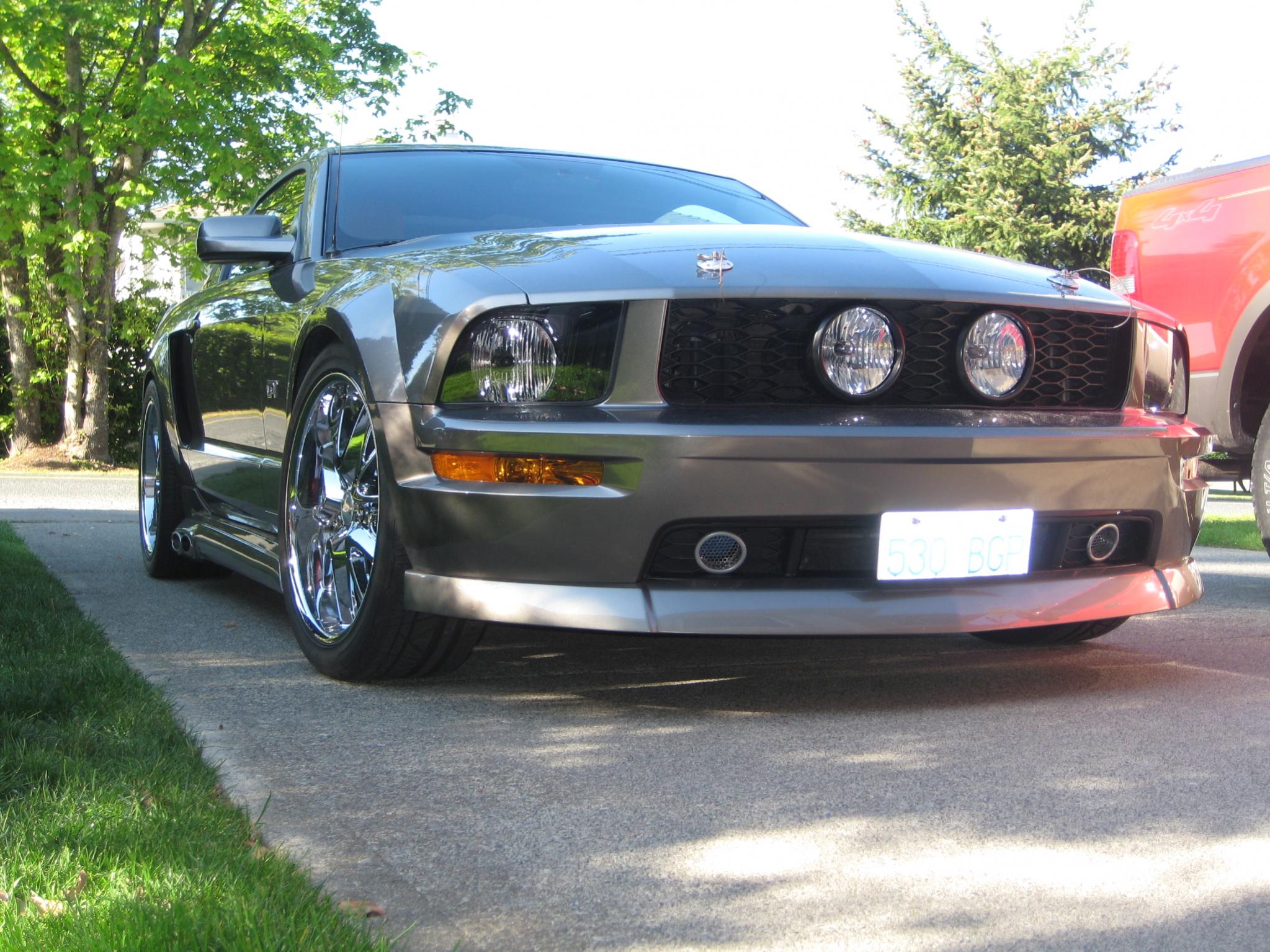

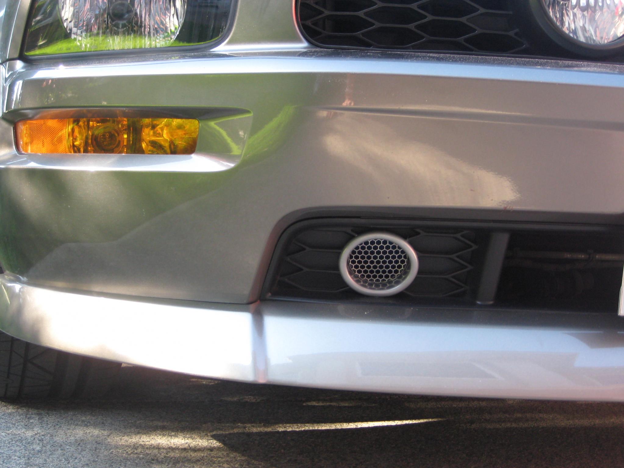

I had another post here https://themustangsource.com/showthread.php?t=482455 that showed the kit I made. The last thing I was needing to do was the grill in the inlet ports. The material finally arrived, so I added the finishing touch.

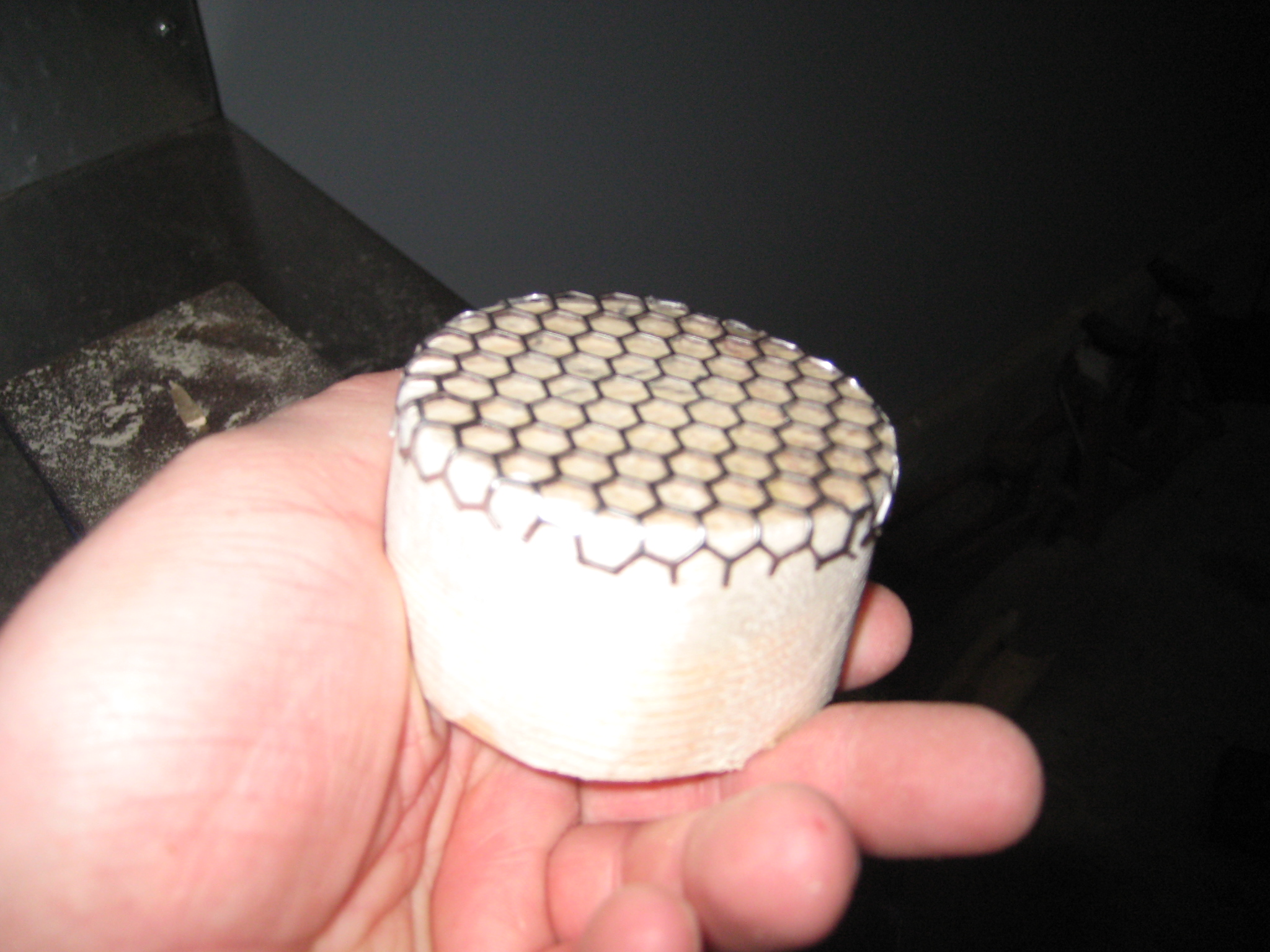

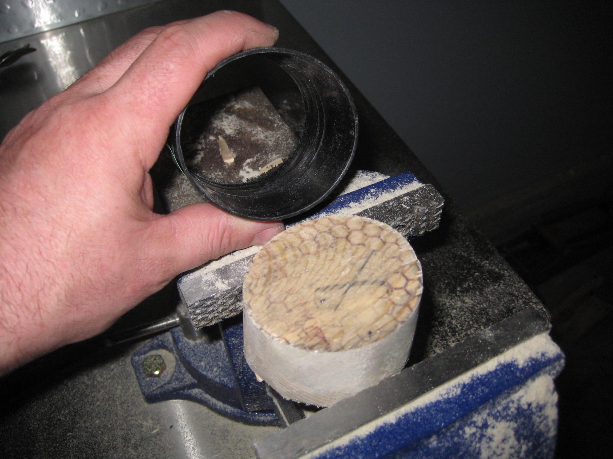

First, I took the extra length of speaker port I cut off and used it to trace on a piece of wood so the oval shape would match the ports.

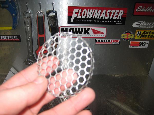

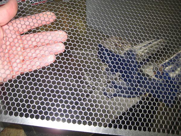

Then I cut out the wire mesh oversize and hammered it around the wood. A final trim after that and the grill for the inlet port was done.
Really happy with the end result. I have noticed a few people giving it a second glance, I wonder if they think it is a KR grill???
Attached Thumbnails Home made brake duct kit officially finished-img_6742.jpg   Home made brake duct kit officially finished-img_6741.jpg   Home made brake duct kit officially finished-img_6743.jpg   Home made brake duct kit officially finished-img_6744.jpg   Home made brake duct kit officially finished-img_6746.jpg

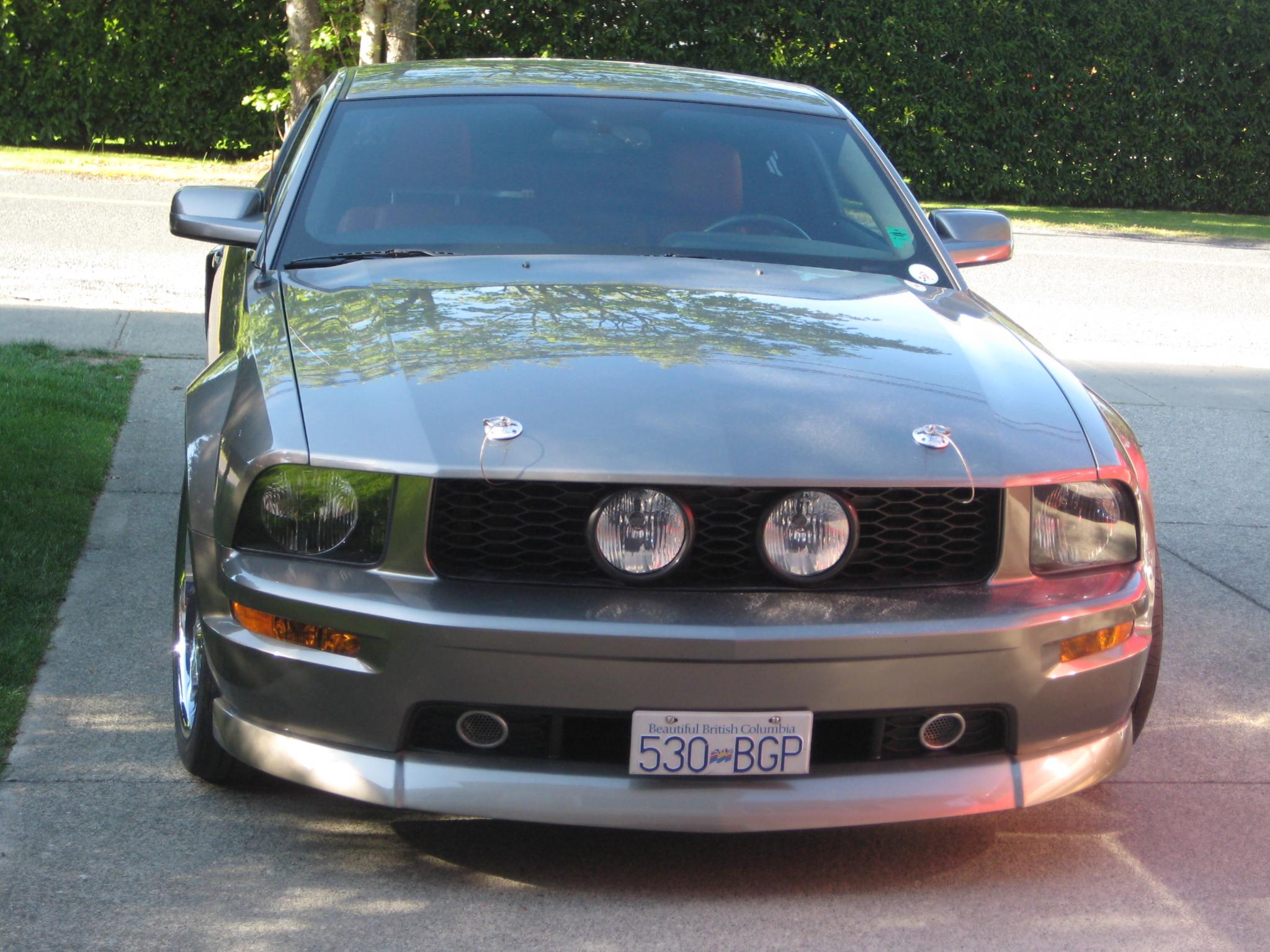

The finished look from a few feet back
Attached Thumbnails Home made brake duct kit officially finished-img_6747.jpg   Home made brake duct kit officially finished-img_6748.jpg   Home made brake duct kit officially finished-img_6749.jpg

Originally Posted by NastyStang113
Where'd you get the grille?
Which one? I assume you mean the brake duct grill, I made it myself. If you are asking where I got the material, I got it at a local metal supplier.
