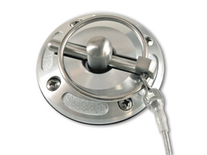

Attachment 38768
Here's the link,
They may be elsewhere, but this is where I got mine.
The threaded part is especially better than others I've seen because everything is aluminum or stainless and will not rust. I am not sure how it will work with yours I think you said you have an aftermarket hood. I will get pictures and as soon as I can get out of work.
http://www.partscheap.com/scottdrake05.htm

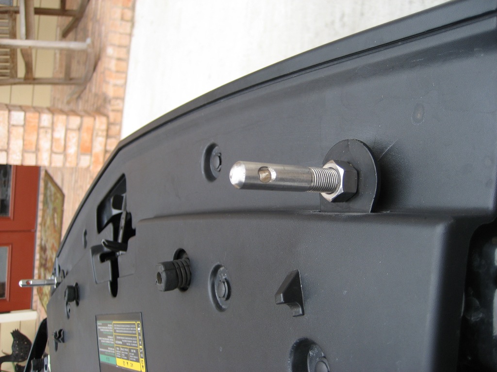

To answer yes same minus the name. Lanyard easily removed and reinstalled and removed. My hood will not move now, not even at 100+. My hood is original hood so it is aluminum so cracking not a problem. The threaded studs can be raised up or lowered in the bracket making the pin tighter or looser. So higher gives more play that won't stress the hood and lower and you have to push down on the hood to get the pin in. I just doble and triple checked everything before placement and drilling.

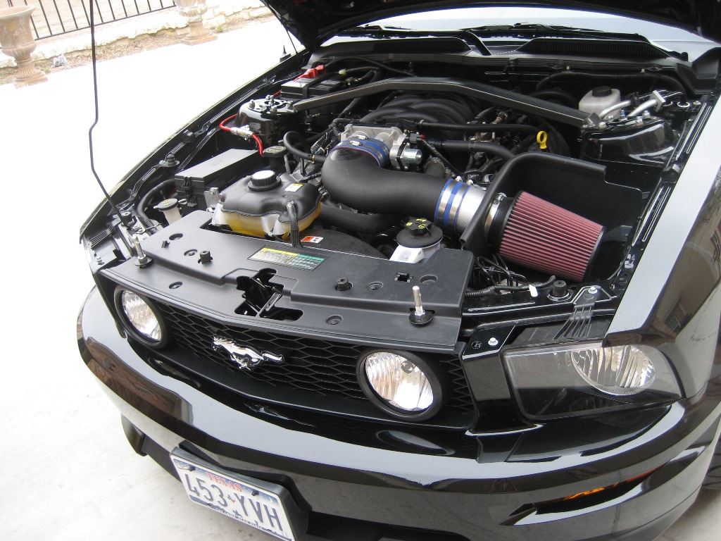

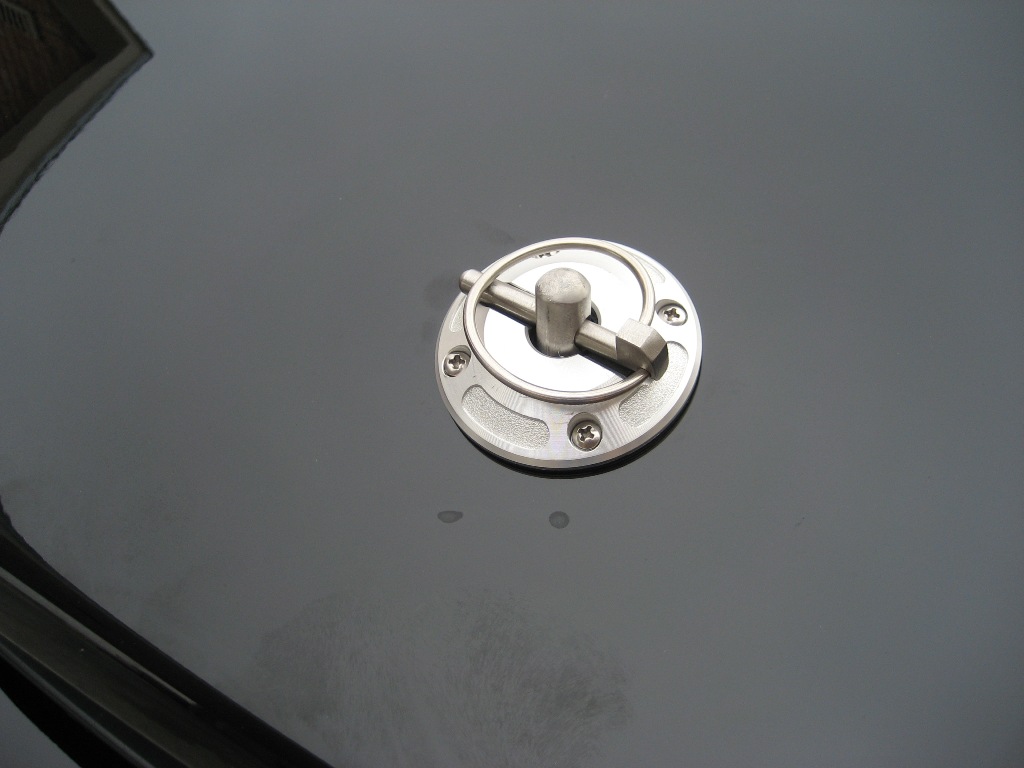

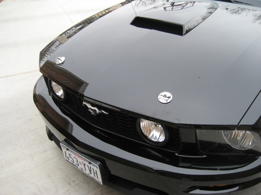

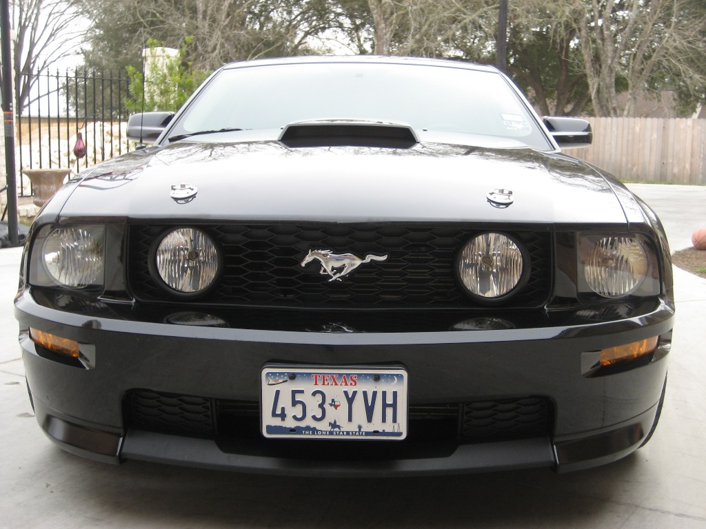

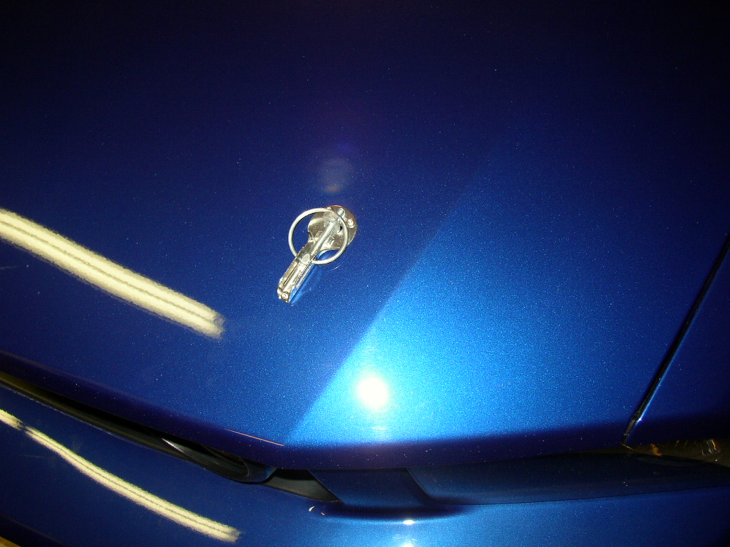

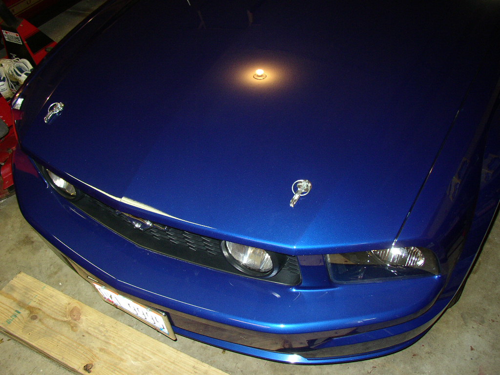

Hood Pin Pics
Finally got pictures of the shelby billet hood pins without logo. Pins are raised a little bit just because of the material. I like it better myself but I am partial. Most pins look cheap to me, but these look like they belong on a nice modern day car with retro look.
