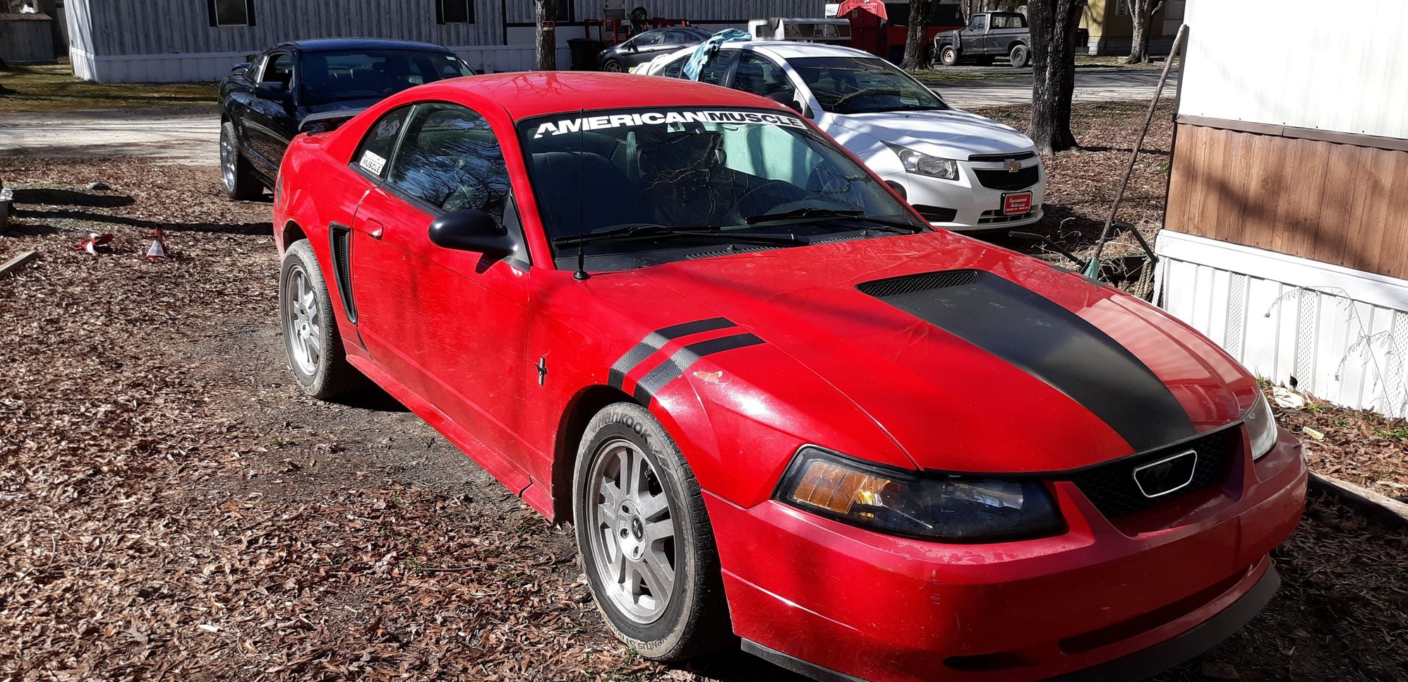

Yeah that's what I was thinking cause I also have a 02 mustang 3.8l v6 and I was use to driving it and when I got the gt and started driving I could feel a big diff in power but now I think I'm getting use to it... and I've heard something about the break away spark plugs but not sure what that is but I'll look it up... the car had set for a year or so when I got it so I'm pretty sure the plugs and wires need changed and maybe the coils? I just got the car a few months ago... it has bbk shorty headers on it and pypes bomb axle back exhaust with muffler delete and a jlt cai with bama tune and I have the 93 octane race tune on it... it came with the bama hand held tuner

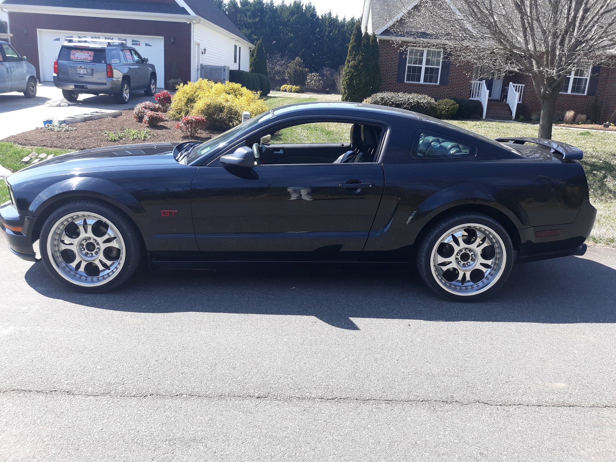

Yeah I only paid 1500 for it his mom just wanted it out her driveway... it's in great shape and runs good... it has bbk shorty headers on it and off road x pipe.. it has the pypes pype bomb axle back muffler delete exhaust it has the jlt cold air intake with bama tune and it came with the bama hand held tuner and I have the 93 octane race tune on it.... it's pushing close to 400 horsepower.... and it cost 1500 bucks all I did was put new gear in the rear...3.55 gears and thanks they are nice wheels

I really want to get some nice 18 inch or maybe 17 inch mustang wheels on my 06 gt.... don't really care for the 20s or the low profile tires...I feel everything in the roads
