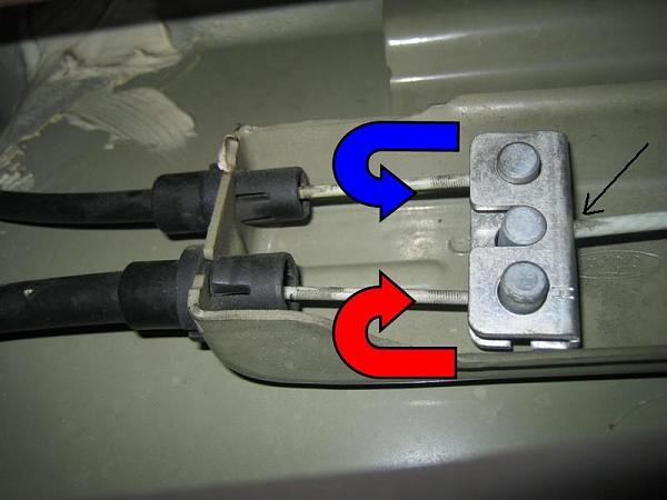

Originally Posted by Boltzman
how does it break
My guess is over time and constant use that the end of the parking brake cable gets worn out since it is always in contact with the metal bracket and eventually gets fraid and snaps.
See pic Courtesy of Tacobill.
See black arrow and ignore the blue and red arrows
