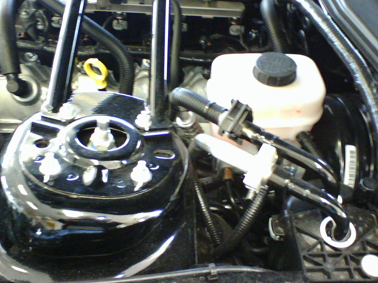

As luck would have it, I was at my dealer today (fighting over my spoiler delete!) and spotted this on the Shelby GT on the showroom floor. They've attached a section of plastic wireloom on the A/C line, so you're obviously not alone. Sorry for the crappy cell phone pic, but you can still make things out...
Wow, thanks man! That's great! I was planning on trying to find a Shelby to look at this weekend. Did it look like the wireloom touched the brace?
Much appreciated.
Paul
It was definitely making contact. I was going to try wiggling the refrigerant line to see how tight it was before I got the "may I help you" that really meant "touch the car and die" from the sales manager.
