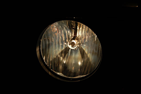

I think this has been discussed, but can't find any info. The chrome plated lens on my fog lights have developed a haze (hard to see in bright sunlight) but very obvious at night. Replaced once by dealer, back again for a second replacement this coming Saturday. It looks like a mirror that hasn't been cleaned for a long time. Takes 2-3 months to develop to where it is obvious. Headlights are OK. I'm running Silverstars...did it pre and post Silverstars. Water is not the problem.
The really odd part is that the haze "pattern" forms three "triangles" seperated by 3 "bars" that are bright chrome....sort of a "peace sign" pattern. Haven't looked yet but I'm betting that the back side plastic molding is thicker where the front side chrome "bars" are not exhibiting the problem. If so it might be heat related..??
I'm guessing many of us do not look @ the fogs when they are lit....please take a look and see if this is happening to yours....maybe this is a new problem for '07??

Same issue here with my '07. Mine had the film on the reflector from the day it was built. If you take a look at the fogs, there is a vent hole in back of the reflector. Not the case with the headlights.
The triangle pattern you see is because of the 3 prongs that are holding the bulb shield in place (see attached pic). No light is reaching those 3 parts of the reflector, hence the dark pattern and why you see no bright film like you do on the rest of the reflector. The bulb shield is blocking the light there.
Since there were others that posted that they had the same problem, even with replacement fog light assemblies, I'm not replacing mine and risking the dealer scratching the bumper, etc. I'll live with it, but I am ticked that the fogs are so chinsy.

Steevr--thanks for the explanation on the "triangle" pattern...it had me stumped. I'll take a look tonight so I get the visual on my car. Also, really appreciate the picture. You would think Ford would change the mfg on this, plug the hole (I wonder if that would help).....why is it there?? Maybe to release heat?? I'm going to contact Ford...I anticipate it will be a complete waste of time, but we'll see.
