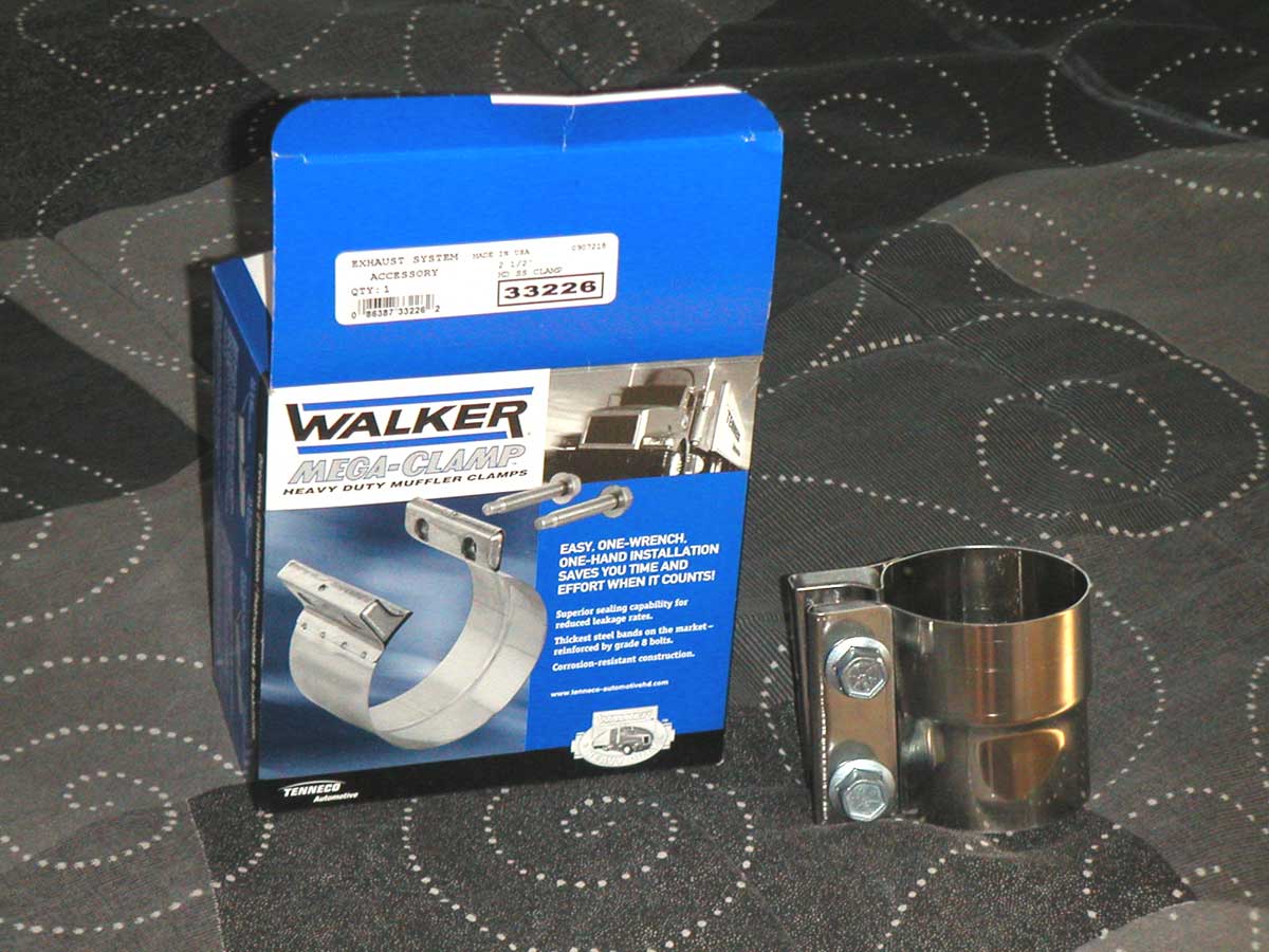

If you think it's your clamps, then try a pair of these. They're not cheap, but they work like a champ!
I forgot where I got them though? Sorry.....

The Flowmaster clamps are junk, the best thing to use is just a $2 U shaped muffler clamp from the parts store.
old thread but still had to update it. well i finally ordered those clamps and installed it today. worked like a charm. also, when i took the muffler off to get the POS flowmaster clamp i decided to start it up and see exactly how loud it would be w/o any muffler..........soooo sweet!

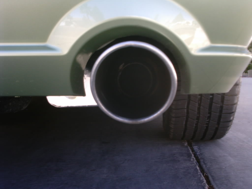

I took the baffles out of my Macs and welded in a2 1/2" pipe
