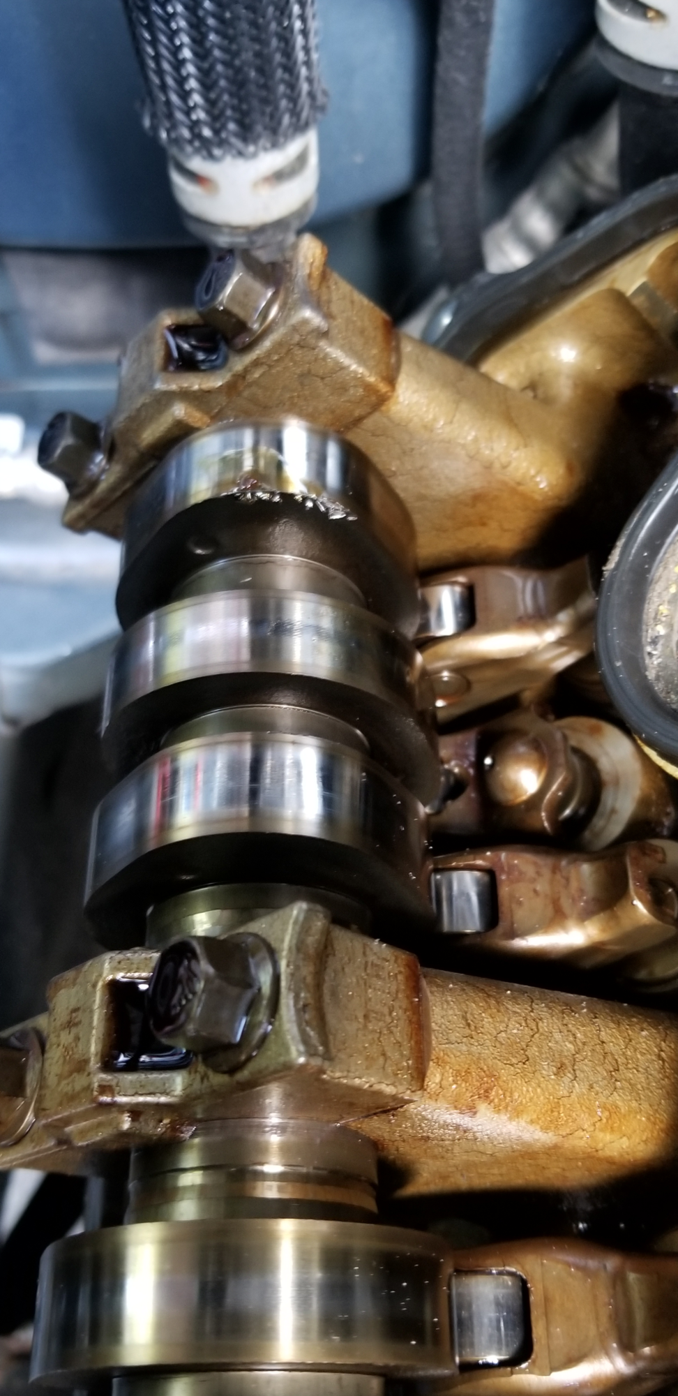

Well look like it is a cam issue. Took the passengers side off and found damage in there.
So what does this mean?
Oh and I live in Canada so our day is July 1st.

Just wanted to update everyone.
My brother came over tonight to look at my car to figure out what's wrong.
He found out that the timing chain is loose. He said he'd never seen something like this. When turning the engine manually the chain would loosen at one point and you can hear the oil gush out.
So I'm going to take it to the dealership and get a quote. Hopefully this is the only issue with it.
