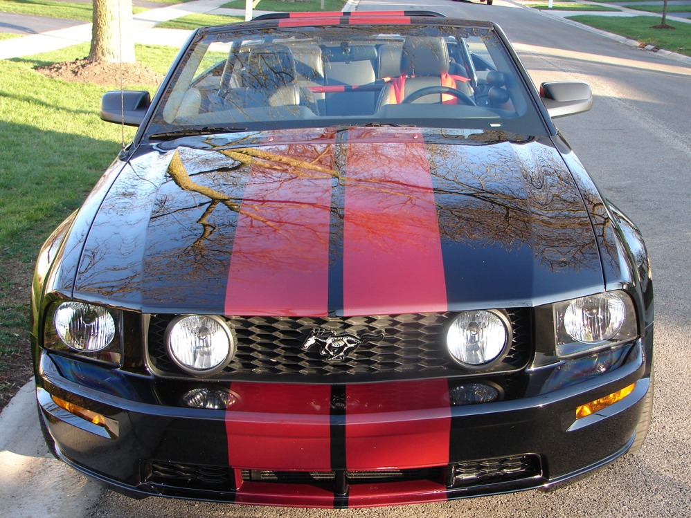

I paid 2200 for custom painted stripes. It is a lot of work.
They have to remove the bumpers, wet sand everything spray the stripes, spray the clear, wet sand, buff and re-assemble.
The look of vinyl stripes will never compare to stripes painted by a good painter.
Paint materials alone were over 600 dollars - 40 hours of labor.
There is no edge to the stripes. When you run your hand across it is smooth transition. The gloss level is the same on the stripes as the base color too, you wont ever get that with vinyl.
12 inches is too wide by the way. 10"-10.75" looks best.
