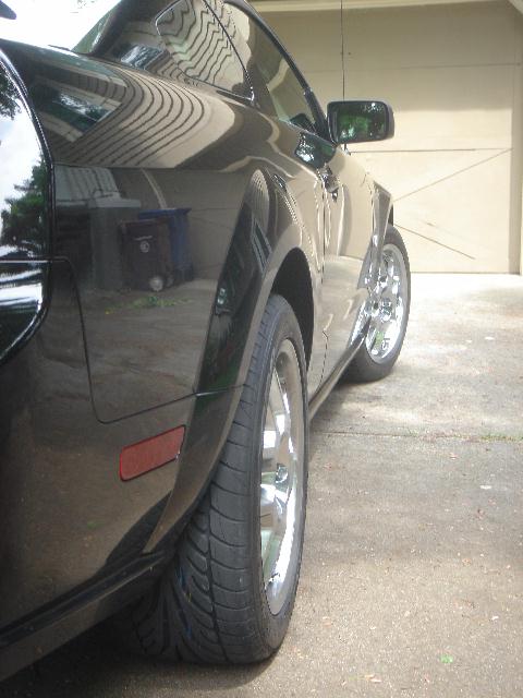

Originally Posted by runfox
Which is one of the reasons I cant understand so many people buying larger tires on the back than the front, then you cant totate the tires. Tires are way to expensive for me not to get the max milage out of them, I dont have any play money yet.
I figure two sets in the rear to every one set in the front. It all comes out about the same, just less juggling of tires, not to mention the better traction from fatter rears... Oh and the 255/45-18's up front and the 285/40-18's in the back just look bad ***.
Also, changing the oil yourself, as others have said, piece of cake...
