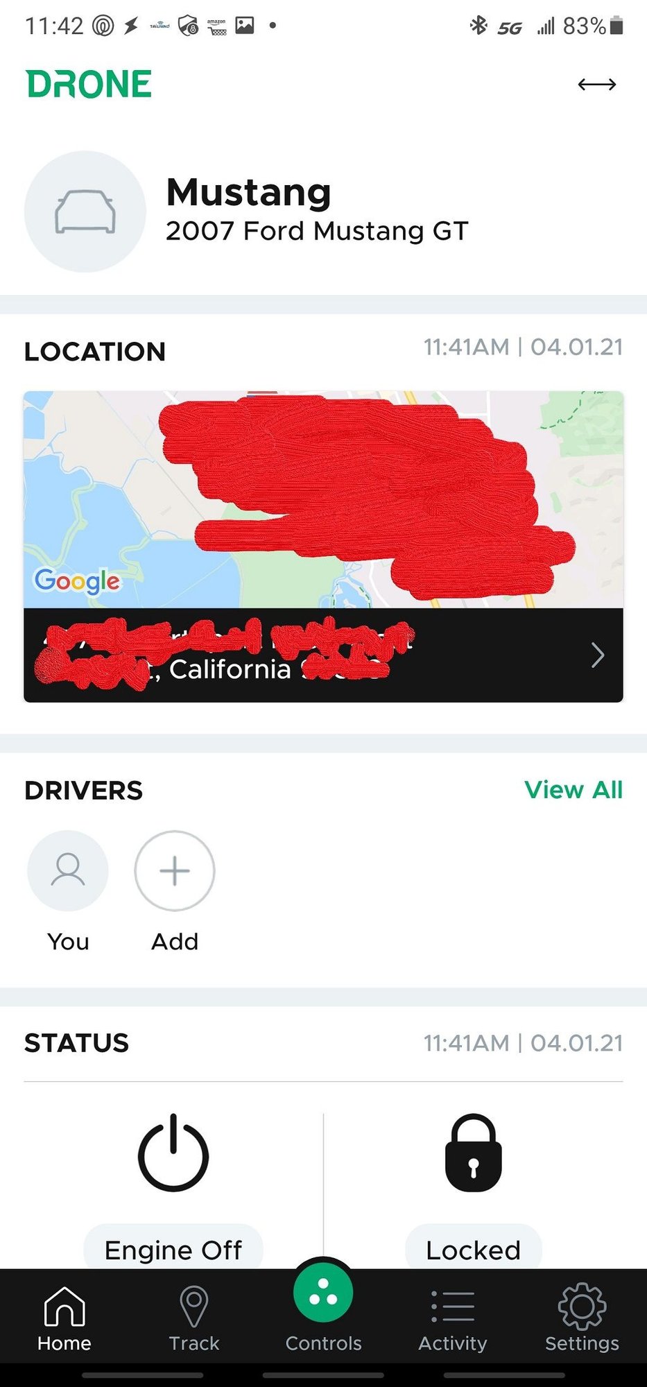

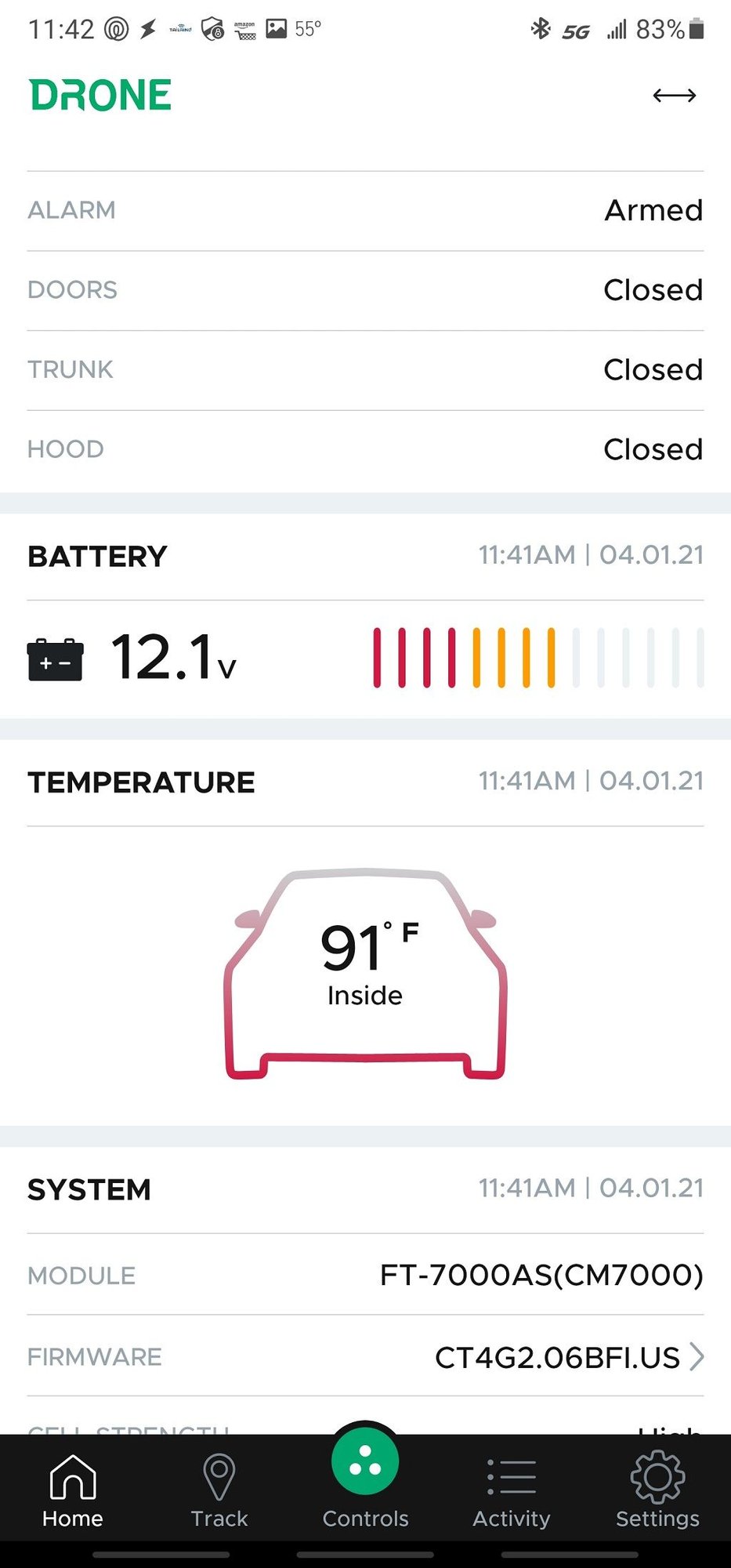

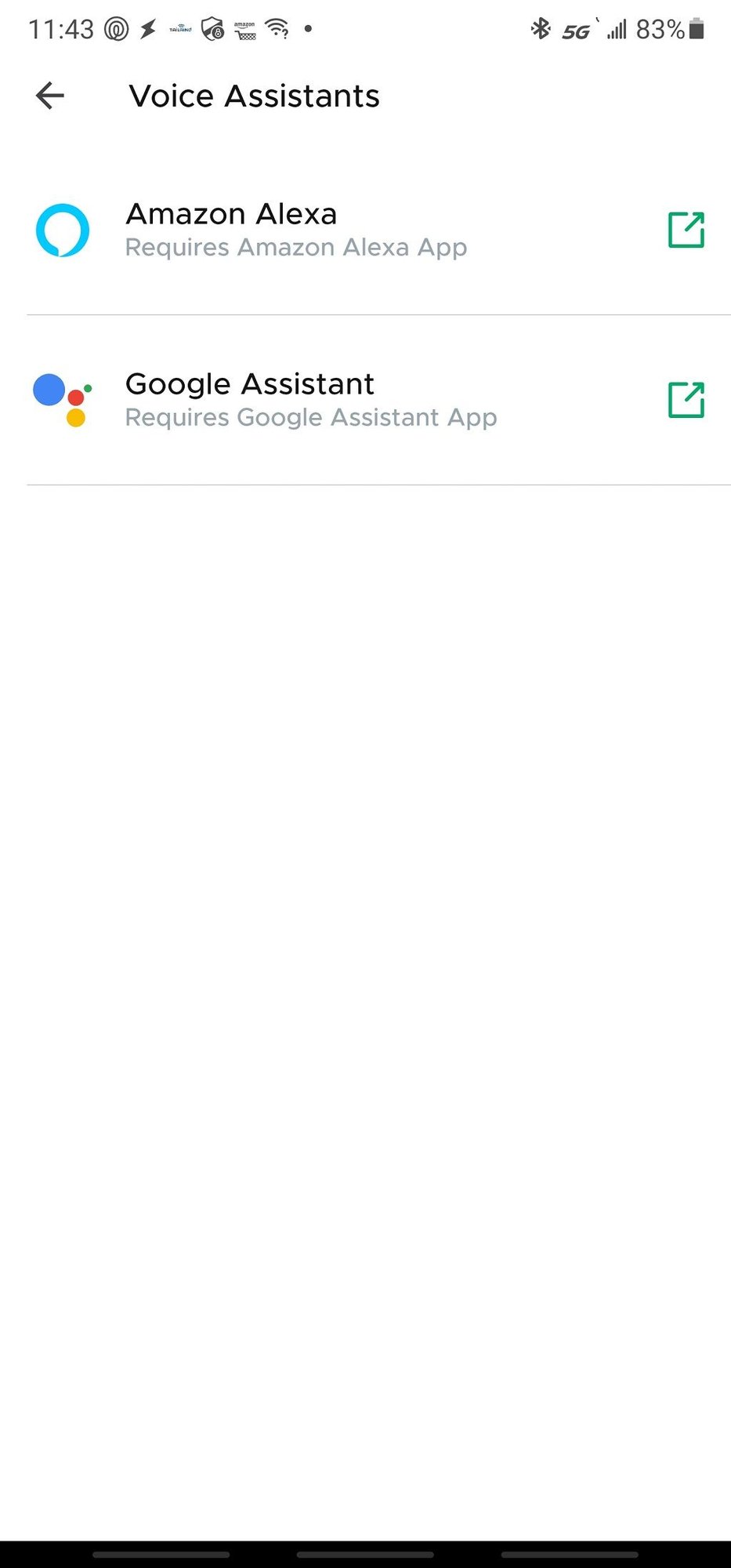

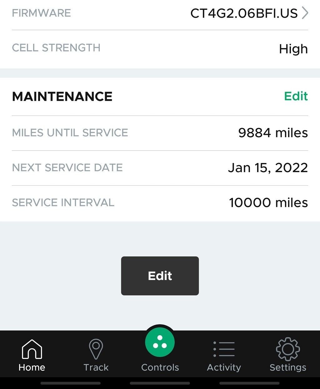

I just installed over the weekend a Compustar Maxit kit for my car. I have the Pro T13 remote with proximity unlock to go with it. This alarm/remote start system will allow you to remote start a manual transmission car. It has the FT-DAS-II sensor which detects forward motion and will shutdown the car immediately if you forgot to leave it in neutral. The Pro T13 remote also comes with a Dronemobile device which has smartphone remote start capability and GPS tracking with Alexa and Google integration. It gives you status of your car such as battery, engine on/off, alarm, doors, trunk, hood, inside temp. Dronemobile requires a subscription with 1 month free. Dronemobile is not required for the alarm/remote start unit. The system also has a Blade-AL cartridge to allow ignition bypass for remote start. I was able to obtain a dealer-only login to get the Blade-AL firmware for my car even though I'm not a dealer. I've also updated the CM module to the latest firmware through this login. I had to install a clutch bypass relay which is required for remote start. To do remote start you have to follow a procedure in the car to get it into "reservation mode" before you can remote start it.
