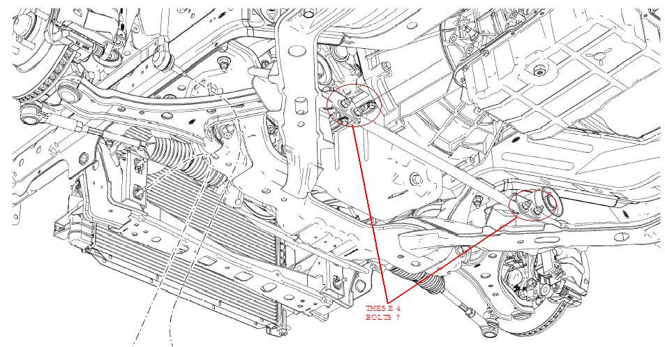

Just asking here... is it these 4 bolts (on the A-arm brace)?
Attached Thumbnails Check Your K-Member Bolts (or how I got rid of the Clunk)-arm-schematic.jpg

Bob got some of them the K-Member is painted black so if your car isn't black all of the bolts that the that part attaches to can be checked........
