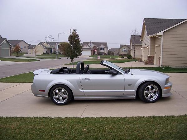

I am going to install Dynamat Extreme with Dynaliner and have a few questions.
1) I have the instructions for the center console removal, however the "center stack wings" need to be removed. How is this done?
2) If I place the Dynamat and 1/4" Dynaliner is placed under the console will the console still fit properly?
3) Does installing the Dyna products actually help reduce the road noise? Or is there a better method out there?
Attached Thumbnails Center console removal for Dynamat install-mustang.jpeg.jpg

That sounds like a good idea. Off topic but is there anyway you can post some pics of your car so I can get a look of how it looks with your rims. Looks good man
I wholeheartedly second that request for pics.

The quality is not the best, but these are the only pix I have.
Thanks! Those pictures look great. I was apprehensive about going with chrome wheels on Satin Silver, but the combo looks great on your pony. Sorry for the brief forum highjack.

Looks good. I might go with some 20'' Chrome deep dish bullets in a year or something.
