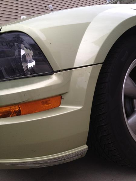

OK so here's the deal, I tapped the front of my '06 with my other car
And previous to that I scraped it on a really tall curb pulling into and inclined end parking space whre the curb did not incline but was about 18" tall at the entrance! You can see the white scrape marks on the driver side bottom.
The driver side has a bigger gap than the pass side does but what I'm wondering is can I tighten the gap back up somehow?
How does the bumper attach?
Attached Thumbnails Bumper Cover loose-driver-front-bumper.jpg   Bumper Cover loose-pass-front-bumper.jpg

Take out the wheel off , you can do it without taking the wheel off but it makes it easier , and take out the fender liner to access the bracket you need to fix. The bracket attaches to the fascia with two bolts and the fender with one. Take the bracket off and straighten it out , I've had to do mine several times ...
Great, thanks for the info. Hope to give it a try this weekend.
