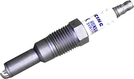

I'm considering replacing my OEM 2 piece design spark plugs as my 05 GT is approaching 31k miles..
After all the horror stories about the OEM plugs breaking in the heads, I understand the Brisk Silver Racing Spark Plugs are a one piece design and considered as a top of the line spark plug..
In the meantime, if anyone has upgraded to the Brisk plugs.. I'd really appreciate your feedback and if you would also recommend them as well..
Thanks..

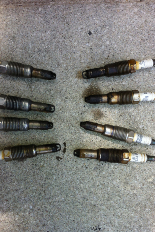

I like to stick with motorcraft.. I just recently did mine... First time i swapped them was at 60k broke one plug.., u really jyst need the lisle tool in ur garage... Great investment and u can keep using motorcraft.. I did them a second time at 115k... They came i out just fine this time since i used antisieze the fist time... Heres how they look with 55k on them.. Euther way your car ur choice but they r kinda expensive for only 18k..
Attachment 143753
I can just picture them at the recommended 100k change interval
