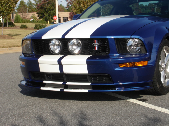

I will probably just do a running pony emblem, with placement similar to this:

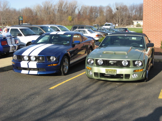

I just use the 2-sided tape that comes with the emblem. Its a tribar from the left fender off of the SN-95's. Haven't had a problem yet. The tape is pretty strong, and there is enough surface area to keep it attached. See the pic of my car below (its the blue one. The green is my friends car)

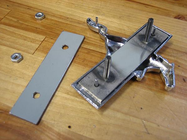

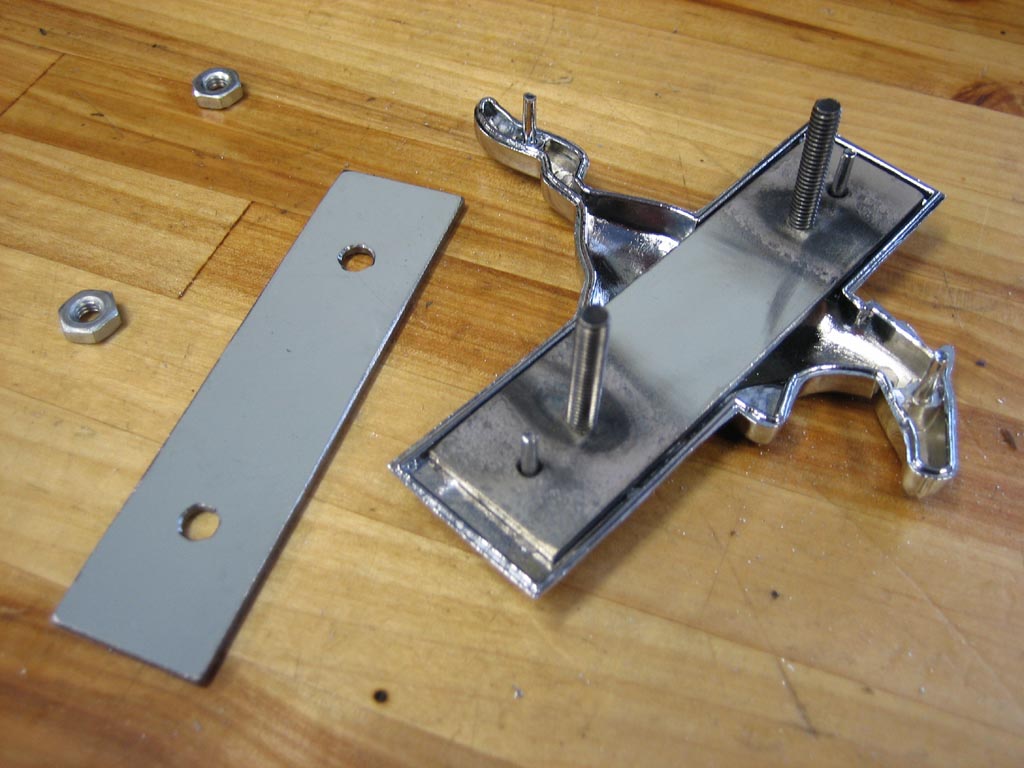

I'll post this again for those of you that haven't seen it. I think that the design is by a board member but I don't know who. This is a very effective way to mount your tri-bar and it's cheap. I had the two sided sticky tape but when the temps hit the 100's it started moving around.

That looks like it would work...does it keep the emblem mounted pretty rigidly?
Temps routinely get over 110* here in the Phoenix Valley during the summer, I doubt the adhesive backing would hold onto the grille for that

Hey Drew, I use my pressure washer at home when I wash my car. Haven't had a problem AT ALL!! The Adhesive holds up VERY WELL!
And about attaching it? Yep, I just push it on the grill, and it sticks.

For you guys who are worried about the 3M tape, you could always use the fasteners that are made to go on the pins. (assuming you get an old school emblem like the one in GRAYPNY's picture) See how he's drilled holes in the mounting bracket for the pins to go through? Just "fasten" the emblem to the plate.

Does the metal bracket come with the badge, or is it custom-made? I don't feel like custom-fabricating a bracket just to put a badge on

It's custom made.
The only one that I know of that comes with a mounting plate is the one from a '70 Mustang. It's the one CDC is selling with their new billet grilles.

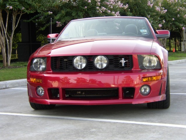

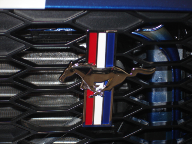

+1 for two sided tape, it is on there really good.
