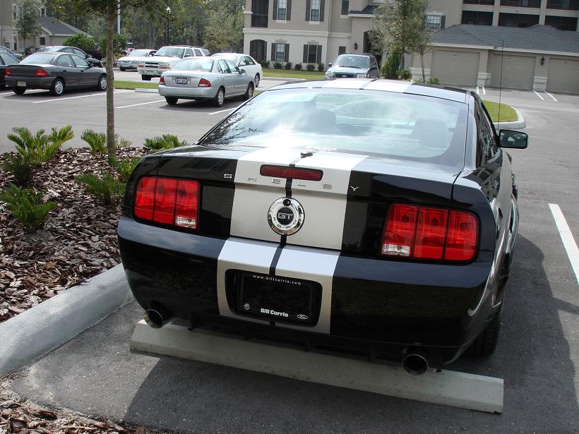

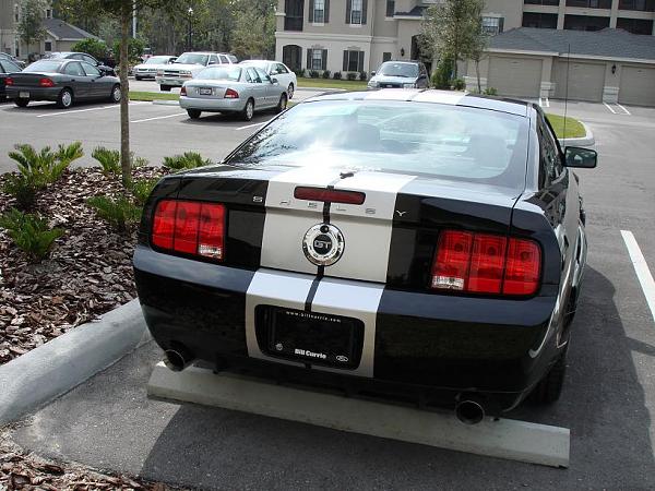

My dad's did come with the Sirius option, so there is an antenna mounted on the trunk lid. It does have the factory antenna on the front passenger fender as well.
This is the best pic I have of the antenna on the trunk lid as my dad drove the car home and lives 800+ miles away.
Attachment 20676
