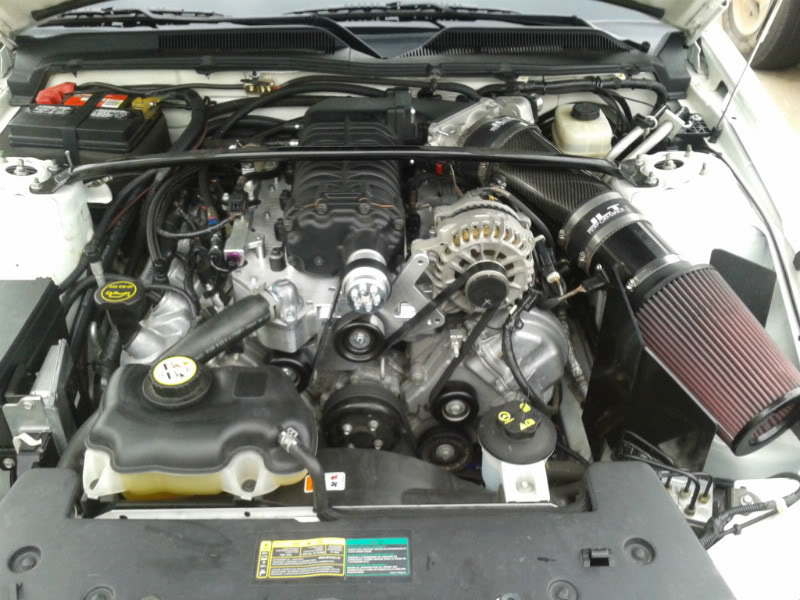

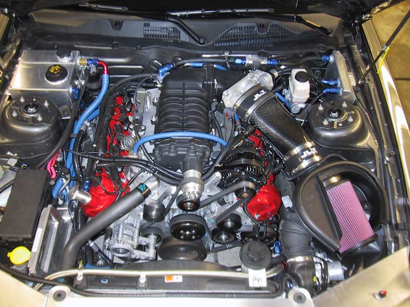

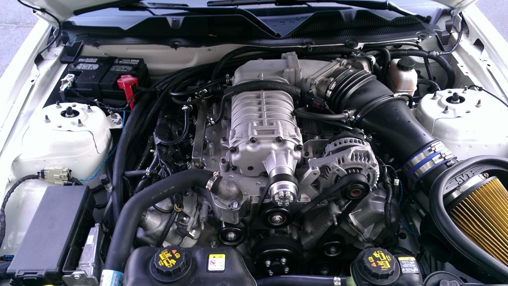

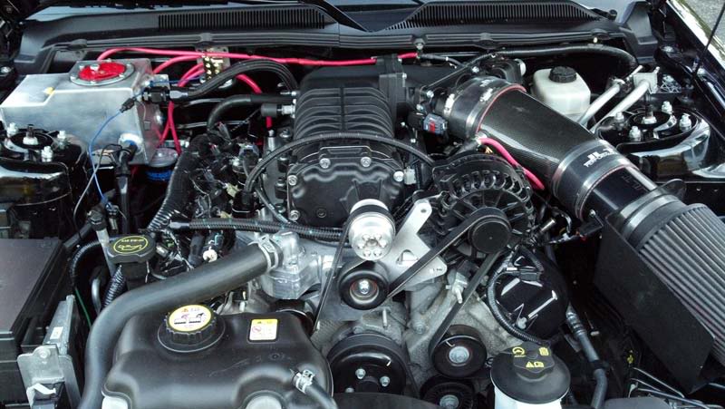

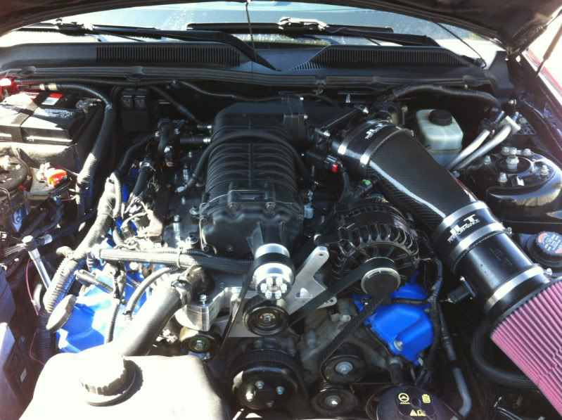

The outcome is excellent like a factory 450rwhp. About as hard as doing a intake manifold. You save money by buying a used low mileage SC and assembling your own parts list. No fabrication required unless you count splicing a wire and cutting a hose.
