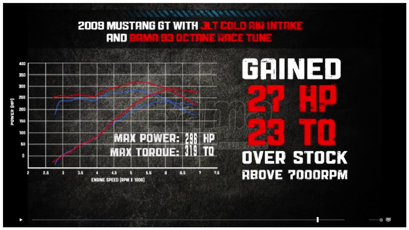

was looking at the jlt/tuner plot, noticed torque/hp lines dont cross at 5252 rpm...looks like its off by 1000 rpm, just wanted to see a correct gain at 6000 redline...thinking about one, but dont feel safe pushing 7k
Attached Thumbnails AM/Bama dyno plot question-bama.jpg

just noticed it also shows NEGATIVE hp/tq below 3000 rpm? somebody needs to fix these plots...

The scaling on that is definitely off (which would make it cross at a different RPM if scaling isn't the same on both hp and torque). I'm gonna let my video team know, and I'll post an actualy Dynojet graph screenshot for you.
