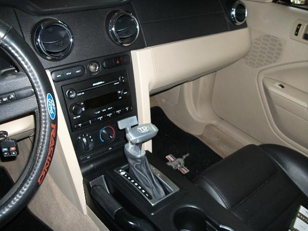

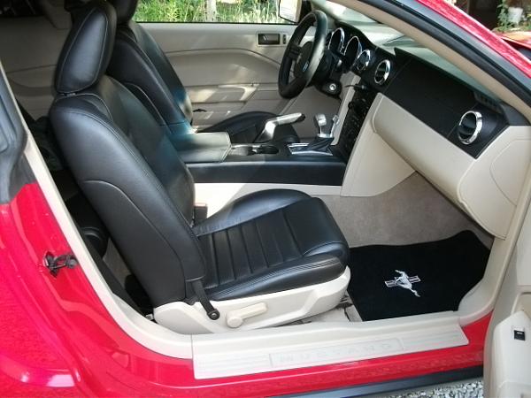

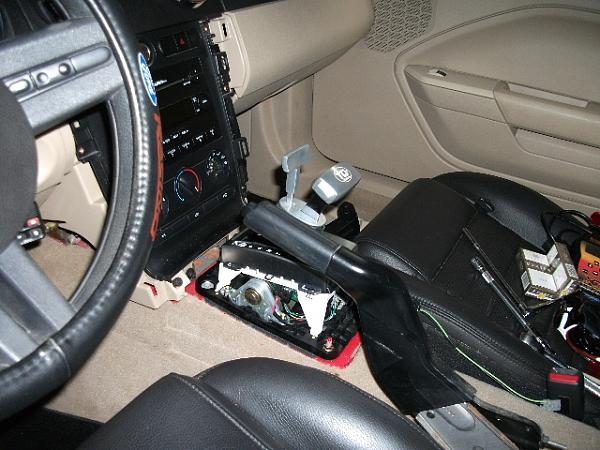

welcome to the forums. not sure as i never had any problems with mine. when it happens are you on any sort of incline? i use my ebrake always to keep stress off the drivetrain components.
if you can swing it, before spending a nickel on the oem shifter, get a tci shifter. its awesome. got mine from am. its not a bad diy job either
