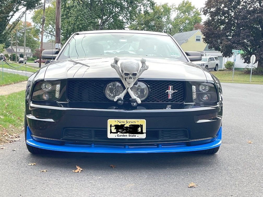

We are all set for Halloween
I just hope the heat from the fog lamps don't melt him. I named him Maurice

Very Holloweenish.

We got em and should have fun with them. Now I'm off to find some old people in crosswalks.... HAHAHA

Very creative, to say the very least.
