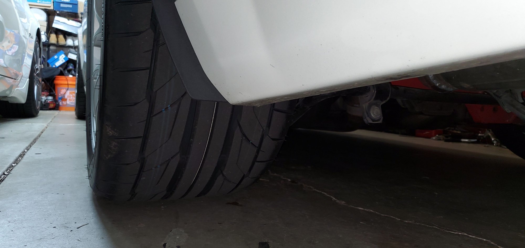

I took the wheels and tires to a shop yesterday so they can mount and balance them. Also had them install new valve-stem-type TPMS sensors that I purchased on Amazon and ditched the OEM band-style. I then mounted the wheels/tires in my garage after picking them up from the shop and retrained the TPMS sensors so I wouldn't get sensor fault errors. I don't have any rubbing issues surprisingly.

offset looks just about "right" -- they poke just a little but hopefully won't rub on full suspension compression

I've been doing some spirited driving and I'm loving these 315's. No rubbing issues yet. These tires really hook and I no longer spin the tires like I did with the 295's.
