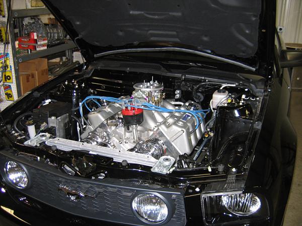

Boss 9 from Kaase
Attached Thumbnails 06 gt engine swap-kaase_boss_589_mustang027.jpg   06 gt engine swap-kaase_boss_589_mustang122.jpg
