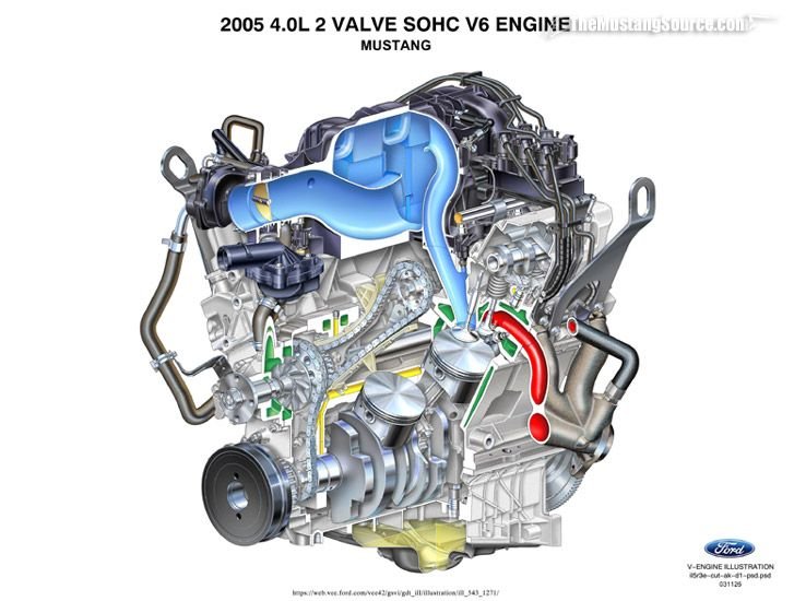

The 4.0L V6 Has Three Timing Chains on it. Two Shown Here. Another Setup on Right Rear Head. Due to the Intermittent Issue I doubt the Chains are at Fault BTMO. I hope it is the Cheapest Solution for your sake! See Lower Left For the SUPERCOMPLETE Version of a Timing Set. It's the Labor that would be Crazy on doing this.
Good Luck!
