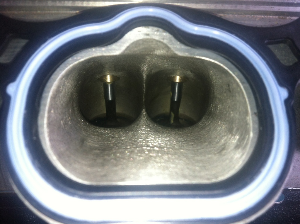

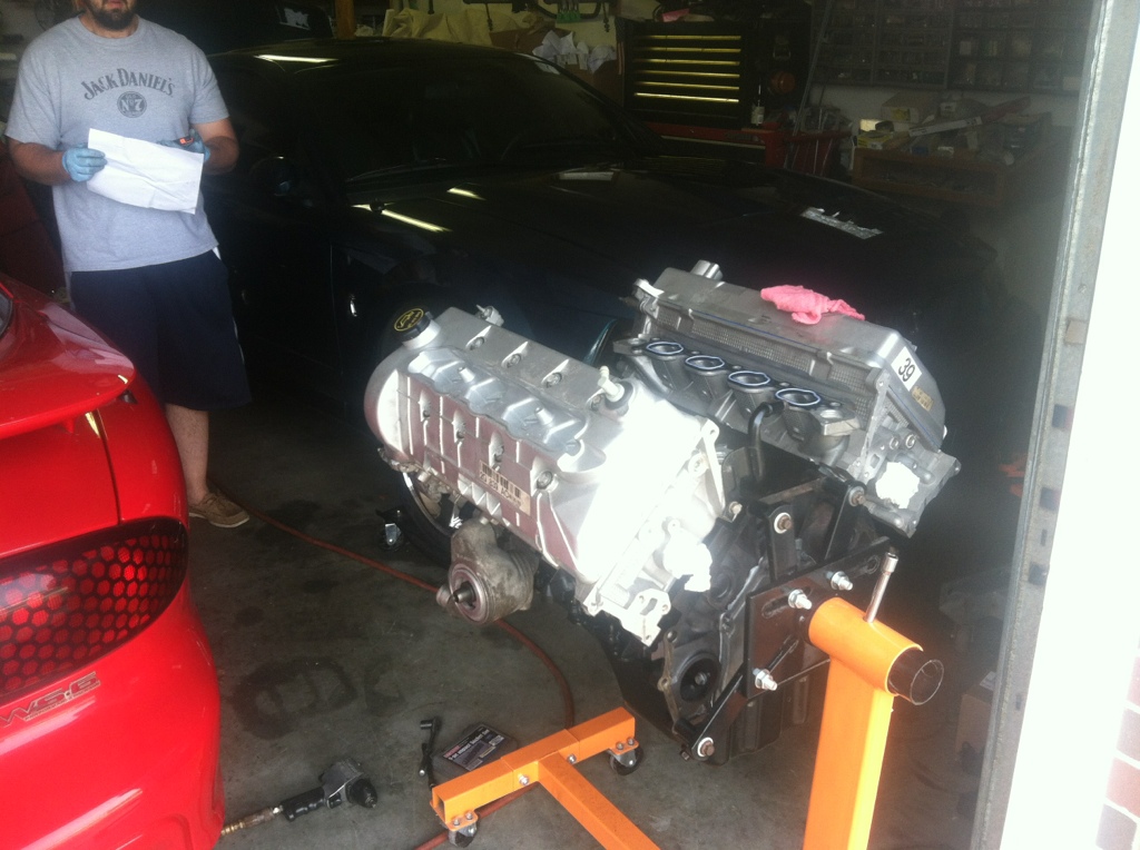

Well MV Performace just called and it's all bad news.
Both heads are shot
All but "a few" valves are bent
#3 & 5 pistons have holes
The block is scored and a total loss
The crank has a hairline crack
So, ground zero start...

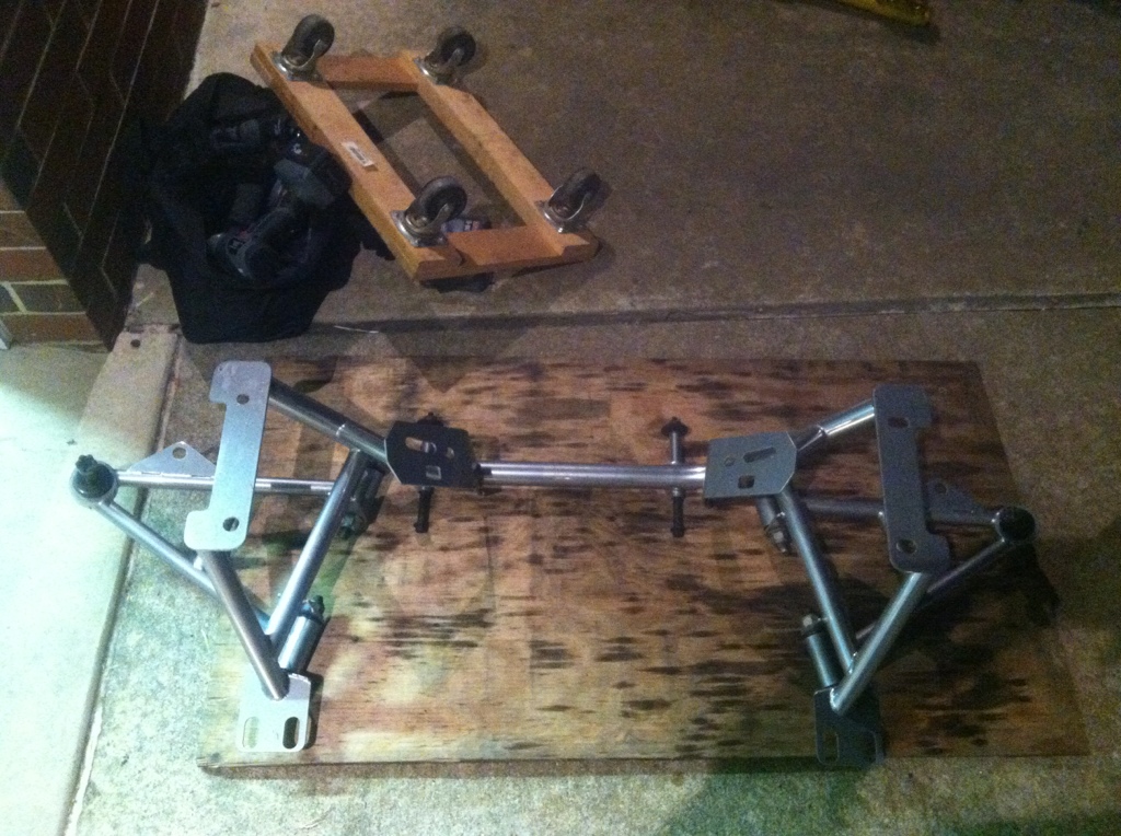

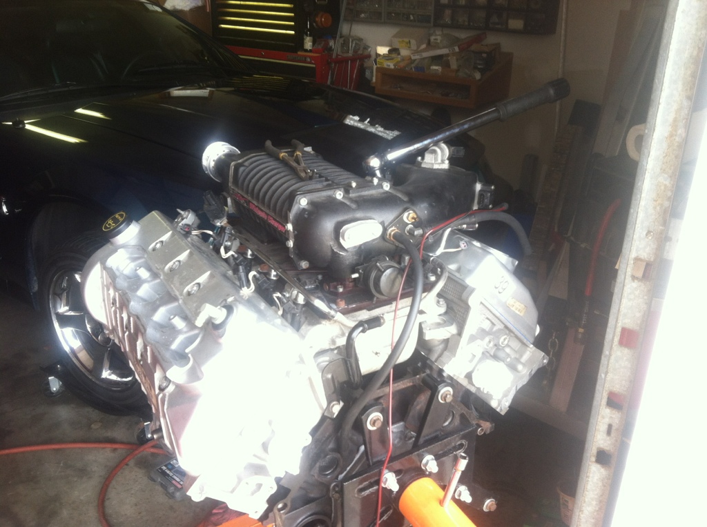

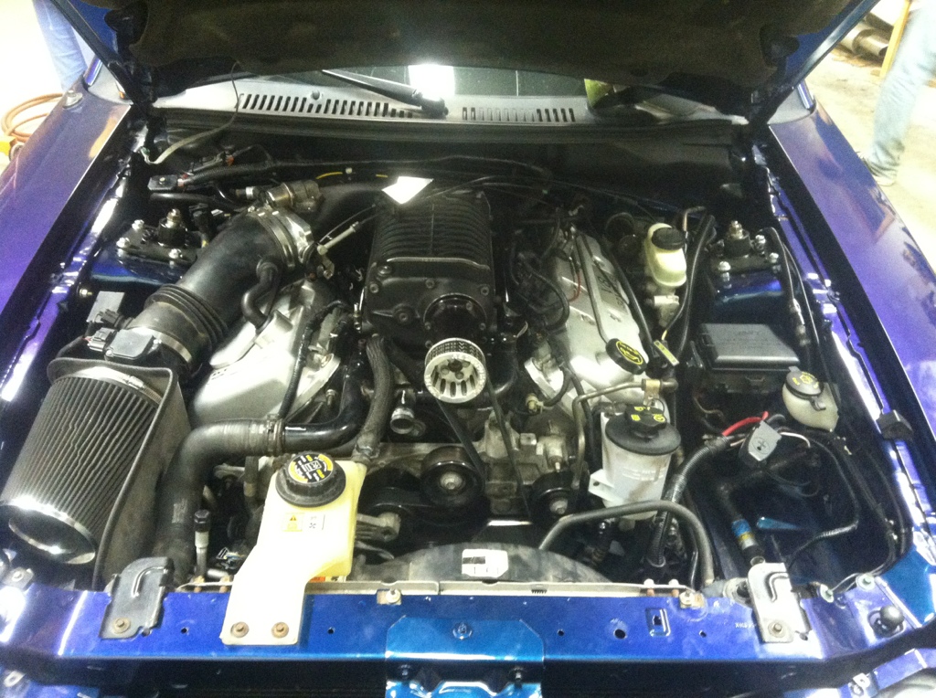

4/11/13
Motor is back
Looks a little better then last time? Loo

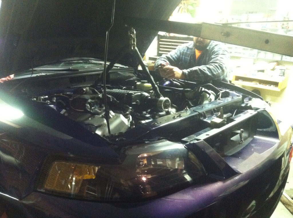

4/13/13
Install
The motor is in, k member is in, trans, clutch, DS are done. I have a meeting at 8am so I rolled early, when I left they where re bending the brake lines(to clear the K member), someone else was putting belts, IC, rad. and buttoning up the front end. They plan on working though the night...
Plan is to DRIVE the car tomorrow night. The tunner wants 500-1000 break in miles, the clutch says 500 break in miles so the car needs to get some miles logged. After that we have to add a return set up, ID1000's, N20 set up, and have a tune put on the car.I would assume the return system and N20 will take a day. They got a fire lite under there *** and go work done today. With no set backs we will make OC with a full running car.
