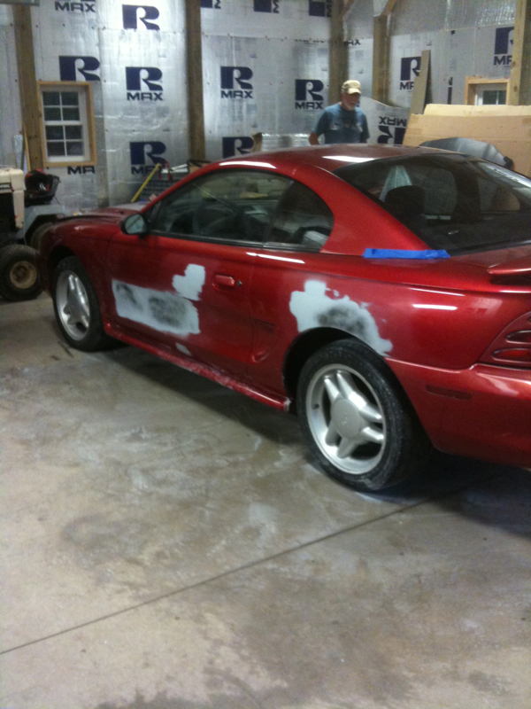

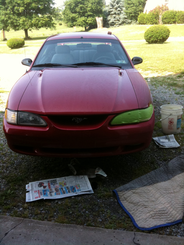

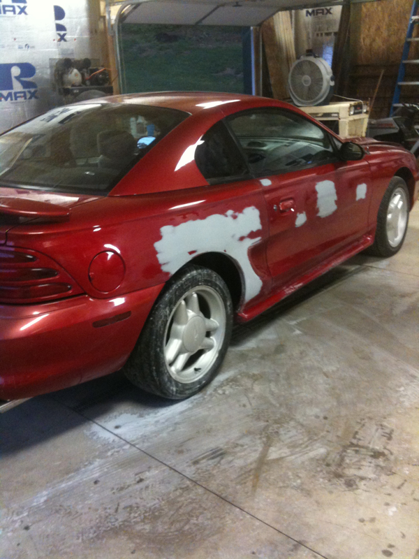

well its been a week and was able to complete the body work. it was very minor. the bottom of my drivers door had a small crease in it and the rest had little door dings from idiots in parking lots that dont respect the stang. lol so now i been wet sanding the rest of the car with 600 paper. thr car is nice and straight now. once i get the sanding time to tear it apart and get ready to spray it. so stay tuned. thr pics are what i have done. will be posting more later

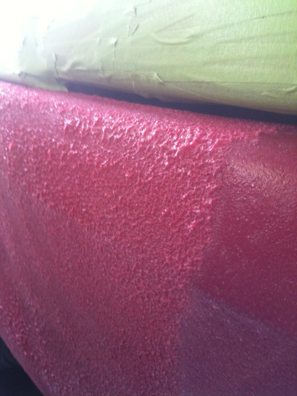

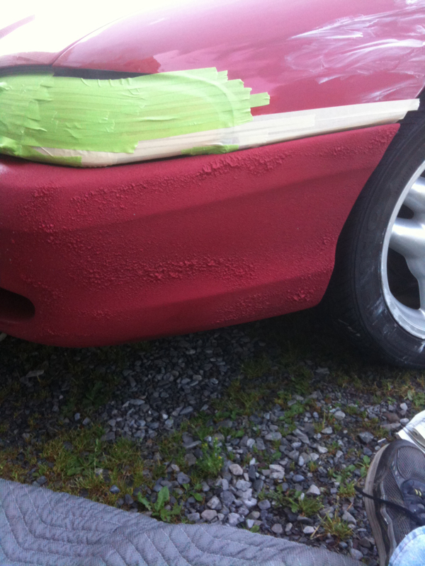

well today i spent the day wet sanding the old paint and i also got some bumper stripper that stuff works awsome on the front bumper. my front bumper had the typical clear coat peeling. so i sprayed bumper stripper on and watch it blister off the clear coat then i scraped it off. then followed by wet sanding. tommarrow is another day. i put some pics up the bumper work. keep lookin for more pics and updates hope to paint in about 3 weeks.

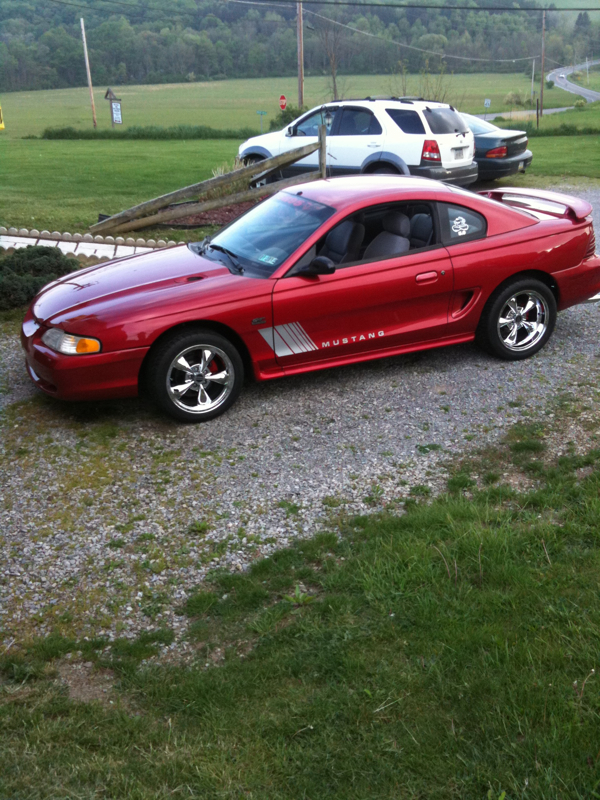

well yes its coming along just fine. im in the process of taking off the factory side skirts right now so i can sand them down. i ordered a new hood from american muscle just a factory replacement for now so i can paint it. they had it for $156 for a new one. couldnt beat it and free shipping to my work. didnt feel like messin around with all the stone chips in the one thats on there now. as far as my color im painting it? i have it narrowed down to two shades i like. i am not tryin to be an *** but my paint scheme and color i like to keep hush till its painted. my closest friends and family dont even know. lol. but i will post pictures as its sprayed and when done. well guys keep the mustangs kickin ***. i will be attending the nationals in carlise which is only 2 hrs from where i live unfotuantley my stang will be siitin in my garage. heres a pic of the stang before i started the project. thanx again fellow and lady stangers
