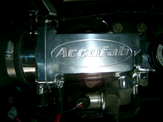

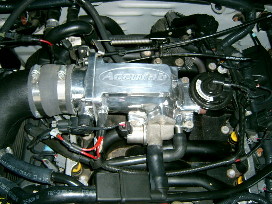

I did quite a lot of research in regards to TB's. As mudshuvel (+1) said the 75mm will harm performance. I have the K&N with a 70mm TB + plenum. Runs faster through the rpm range however I have ended up with a slightly rougher idle which I must add is not a problem at all. The increase has been actually quite suprising.
IMO be it plastic or metal the CAI will allow cooler air to be sucked into the engine from a nice cool location through a less restrictive filter and the TB will allow it to pass even faster to where it needs to go.
I would go with which looks cooler, or what someone recommends, or draw out of a hat. Either one will increase performance and make the engine whoosh and whistle.
I say go with the 70mm TB but when you do go with the plenum as well. It will be a quicker, easier install, look more complete and compliment the TB as it should. Just watch for paper stickers stuck to the bottom of the old throttle body falling into that dark hole when you take it out and have a drill ready to drill out the old screws from the throttle position sensor because HOLY LOCTITE!!!! Install took me 30 minutes and I am a novice. Will post install instructions for all my parts soon.

Awesome info and pics. I've been admiring that Accufab TB/plenum combo for a while now, even with the steep price. Sounds like you definitely feel the increase. Where is it most noticeable, off the line or higher in the revs??? I have bought the "Improving 4.6 liter dyno performance" and several other 4.6 books that state that the stock GT 2-valve engine will pick-up about 12 horsepower with the Accufab TB/plenum combo. Up to 17 horsepower with a supercharger. The Accufab gets an extra 2 horsepower or so more than the other plenems. Funny thing is they state the actiual HP increase is identical with both the 70 and 75mm TBs with the Accufab plenum. They state that you should definitely go with the 75 mm TB if you are going to supercharge, but it doesn't matter if you naturally aspirate. My only decision now is the 70, or 75. I don't plan to supercharge, but who knows down the road.

I still say go with the 70mm. As far as noticable performance is concerned the pick up is noticable through all the revs, however what is more noticable is the way the revs rise so much faster. I want my mid pipe installed now. MRT-H with high flow cats should see even more of an increase and will hopefully help drop the revs a little quicker. That is where my current setup is failing me at the moment. Failing however is a strong word and its not a problem but something I am out to change for my own satisfaction.
You will find a much quicker pick up, its not through any specific rev range though, its the whole range. Best way to describe is if you close you lips and with a little hole breathe in hard then try again with that hole larger (perform in front of mirror so you can see what you look like-ha ha).
I would also reccomend you consider install of TB + CAI at the same time. Just be extra careful to photograph the setup before you attempt install.
If you have any questions or concerns regarding the install or if you want additional info please PM me.

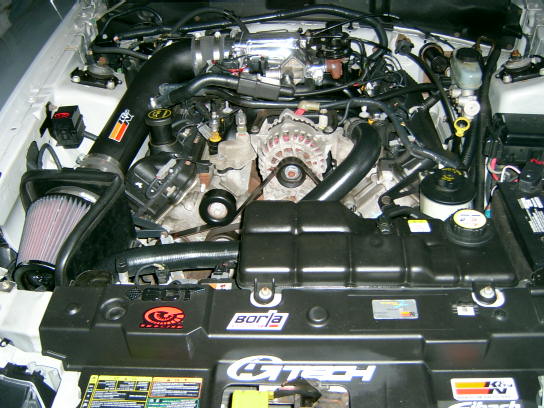

Just installed CAI and TB/Plenum
Thanks for all of the advice. I just installed a K&N FIPK and an Accufab 75mm TB/plenum combo. Wow, what a difference. The car feels stronger at all speeds & revs, but over 3000 RPM, the thing is now very strong. My buddy who helped me install and I were both very impressed. A little dissapointed that the Accufab TB/plenum came without any instructions or parts list. For $400, they should print something out. It's a very nice piece of equipment though. The K&N FIPK seems of very high quality too. Once I burn up the current tank of gas, I'm going to install a Diablo Predator tune, and that will be it for the year.
Next year, 3.73 gears and a MRT H-pipe with high-flow cats. We have strict emissions tests here in Maryland, so I'll have to get a pipe with cats, unfortunately. Anyone know if installing an h-pipe with high-flow cats is going to increase exhaust loudness any further?
