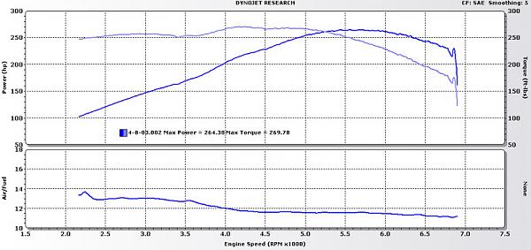

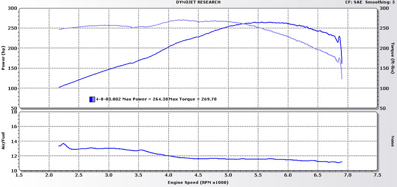

My '96 cobra put down 264rwhp/269rwtq stock.

at what rpm was that?

peak trq was around 4200 rpm and peak hp was from about 5400 through 6000rpm. Look at the graph i posted, the rpms are along the bottom on the X axis.

My dyno stats are in my sig. The biggest problem with the "first gen" Modular Cobra's is they are pig rich. Changing my spark maps to the 98 versions, leaning out everything from 4000 up, and playing with injector timing I'm close to breaking 300rwhp.
NOTE: The numbers below are without my Dr Gas X-pipe.
