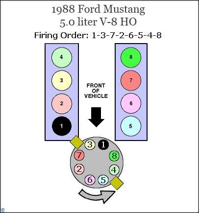

I thought my rotor button was supposed to point at the #1 cylinder at tdc.
Found this picture of the firing order and cylinders. Number 1 is closest to the front and on passenger side
when it's on TDC you can put #1 on the distributor any where you want it

Originally Posted by bluethunderhorse
It's supposed to, but when it's on TDC you can put #1 on the distributor any where you want it
Oh i understand. Cause my number 1 spark plug wire off the dizzy is up by the plenum
