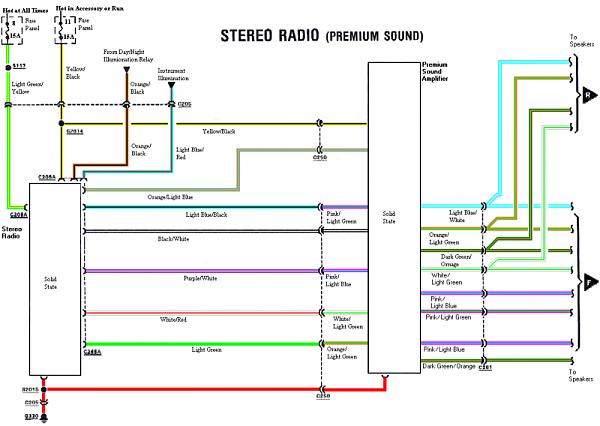

Just bought a 86 stang convertable. Guy I bought it from rewired all the speakers with 12 gauge speaker wires. But I can't figure out how to get power to the radio it looks like he has a harness that he wired it too but its just not getting power or not grounding out right. If any one has any suggestions or a diagram of some sort it would be much appreciated.

this is for a 88 and i dont know if they are the same

It looks close I'm going to take the dash apart and check it out thanks for diagram.
