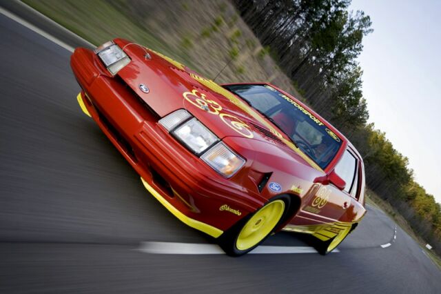

Old Jun 27, 2008 | 01:37 PM
svopaul's Avatar
Service Manager
Joined: June 29, 2004
Likes: 626
From: Odenville, AL
Originally Posted by Scothew
Ill kill Paul if he ever gets rid of this car.
Well while it is not for sale....everything has a price .....But the wife has told me that I am not to sell this car.

Here is the other SVO.....
