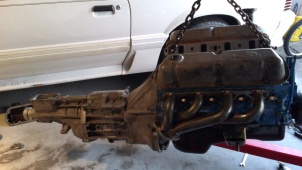

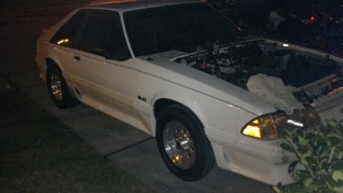

Sup everyone....well I finally dropped the 351w in my 91 gt. Did it this weekend. Motor and trans is in. Now just gotta wire everything up. Should have the intake upper and lower manifolds in tmrw. Still debating on keeping the a/c...wifey says keep it lol. But im not really gonna drive it during the week....just weekends and dragstrip. Anyway just so excited and wanted to post my 9 y/o wanted to help a lil....she went through 6 pairs of gloves just by jacking the engine up hahaha

Looks good and a nice choice for a swap. I got a white '91 myself. welcome to the forum

Nice Fox dude
