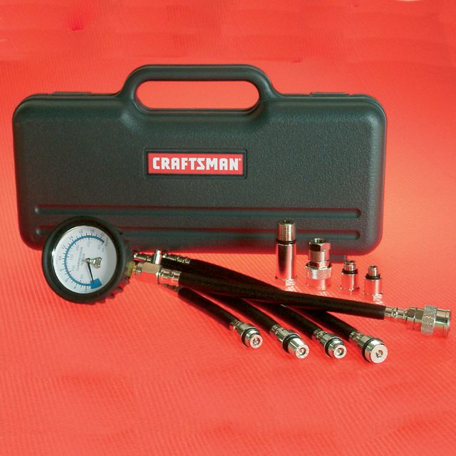

A compression test measures cylinder pressure made when the piston travels from bottom dead center ( BTC ) to top dead cemter ( TDC ) with the valves closed. The reading is taken at the spark plug with a compression tester.
Before starting the test make sure all the plugs are out and the ignition and /or fuel system is disabled for saftey.
Instert the comp tester into the spark plug hole and crank the engine 5-6 times. Note the 1st and final reading and also note the amout of times you cranked the engine. if you test cyl. #1 and cranked 6 times then do all the same crank each 6 times, also make sure you have good battery health you want the motor to turn over at the same speed ( all of these could effect readings).
Repet above on each cylinder.
The most import thing in a compression test is consistency between cylinders. The rule of thumb is to have less than 10% difference between cylinders. If a motor has an average reading of 150psi there should be less than 15psi between the highest and lowest cylinders.
