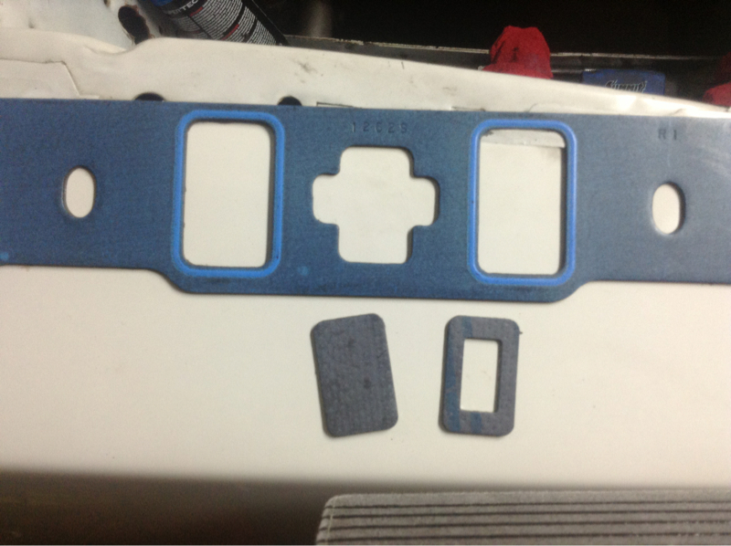

Thank you guys, i did a comp test and all cylinders are good and very very close in numbers. Also the intake manifold gasket came in today and i am not sure about tis two little extra gasket parts? Where do they go? Do they need to be in there? Why 4 when i can see only two places where they might go? Thanks

Im thinking if all the ports are even, and one is slightly different, maybe its a shim to make up the difference? Just guessing. Send a pic of the intake manifold if ya got one

Almost looks like the cross looking section in the middle is where they go. Sort of looks like you can either have a hole their in some intakes and not in others possibly

I think LivinTheStangLife is correct. The small piece of gasket with the whole in it would be used if you had a street head and wanted heat to flow into the intake to warm the carburetor more quickly. If you wanted to block off the heat to the carb in race applications , you would use the solid piece to cover the whole in the head below the cross part of the head gasket. Heads designed for racing often do not have a hole in the head under the cross part of the intake gasket and probably would not require either one of the small pieces in your picture.

Thank you guys. Manifold installed with solid piece and no issues, and no vacuum leaks runs like a beast. Tha k you guys.
