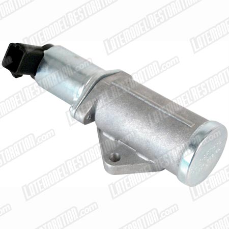

Try cleaning your IAC and throttle body. also check your plugs ( or change them & stay with stock oem motorcraft replacements) and if the wires are old change them. pull the distributor cap and check for worn out terminals and arcing ( spider) marks. sounds like it might need some further tlc is all.
fogot to add in case you needed this is what the iac looks like:
and they get clogged with carbon. some carb/choke or throttle body cleaner will work to clean it.

I had to take the throttle body apart to replace the fuel injectors and I don't remember seeing that piece. Where do I find the IAC?

My bad the 3.8 might not have a iac. It would look like the unit above but in any case clean the TB, and check the other things. If after this it still has a flat sopt then might have to move onto ignition.
