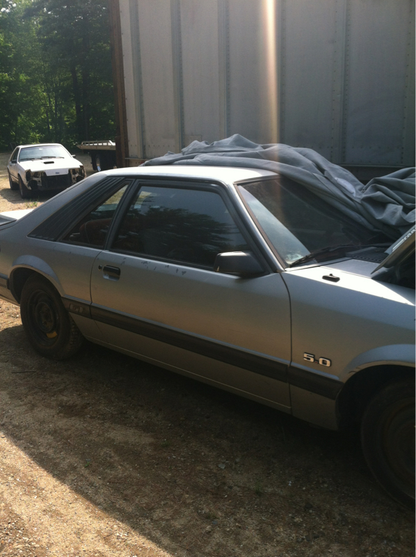

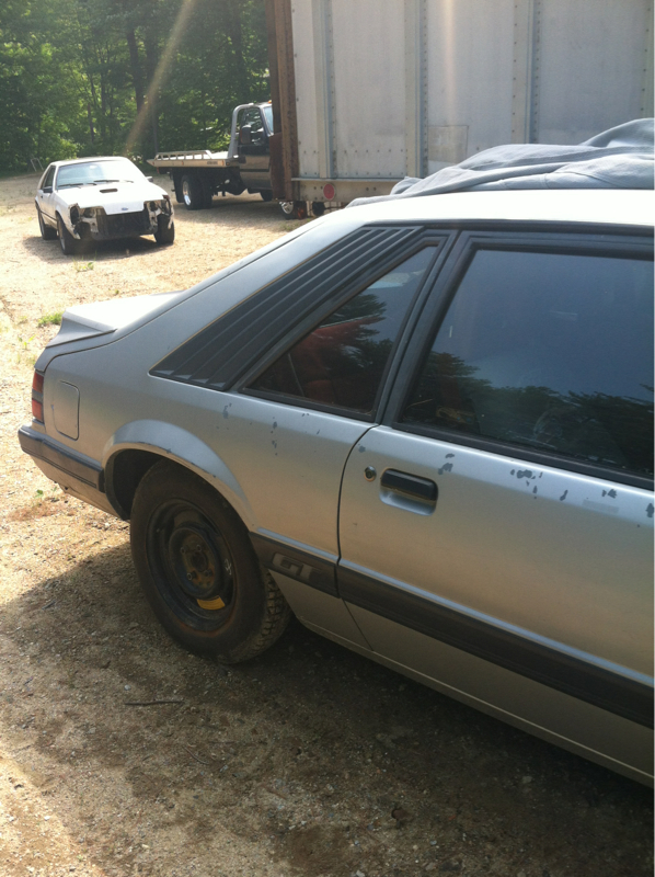

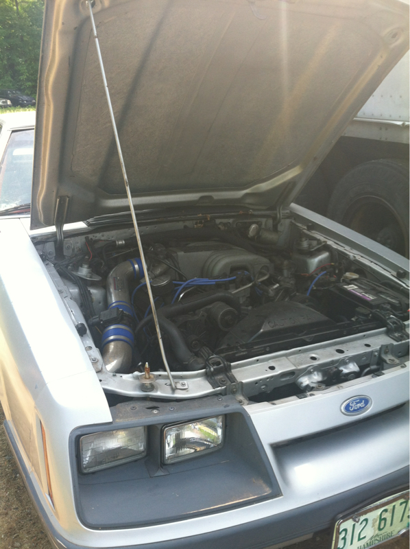

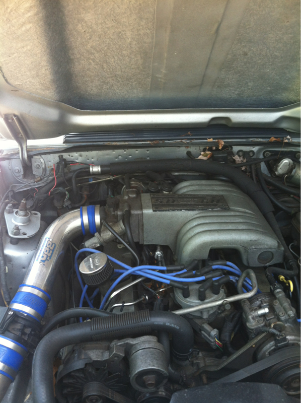

Went by and took a couple pics. Body has 54,000 miles on it. Did a engine swap to a 91.
Attached Thumbnails 86 GT-image-1782749668.jpg   86 GT-image-1050233395.jpg   86 GT-image-977619301.jpg   86 GT-image-492376805.jpg
